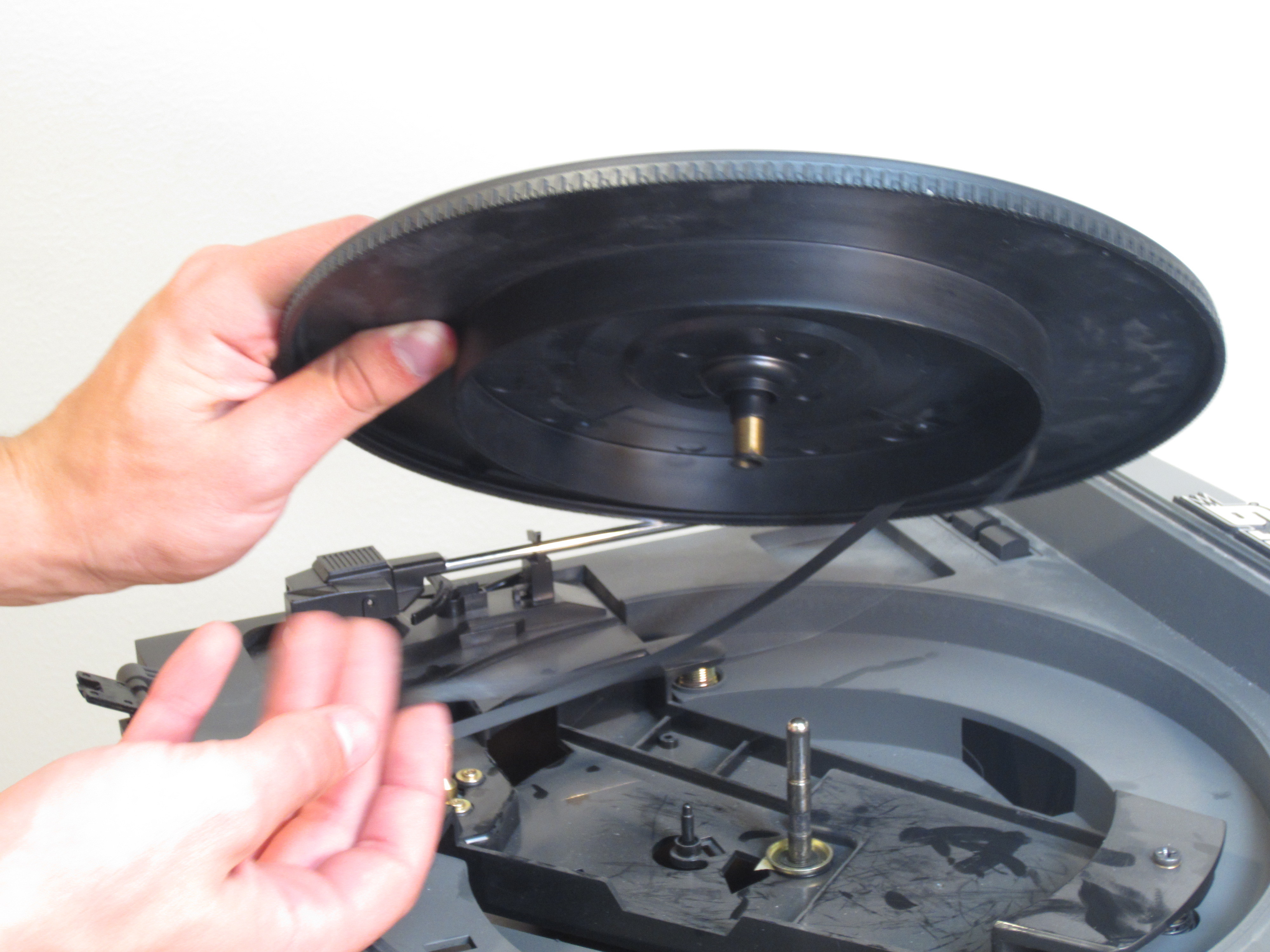

  3. Disassembling the Teac DC-D2831: step 3, image 1 of 2 Disassembling the Teac DC-D2831: step 3, image 2 of 2
    • Gently lift the turntable from the rest of the device.
    • If the device has a faulty belt, see the belt repair guide here: Belt Repair Guide
