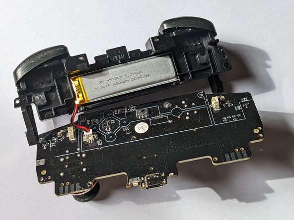

    5. Disassembling 8BitDO Ultimate 2C Wireless Controller (Wukong-Edition): step 5, image 1 of 2 Disassembling 8BitDO Ultimate 2C Wireless Controller (Wukong-Edition): step 5, image 2 of 2
      • Carefully pull up the main board and the trigger buttons section. The only thing that holds them in place once the screws have been removed is a plug that attaches the main board to a secondry board that hold the additional buttons (x-box, start, select, etc.)
      • The trigger section is not attached to the main board except for the battery connector, which connects the board to the battery that is in the triggers assembly group.
      Ask FixBot
    6. Disassembling 8BitDO Ultimate 2C Wireless Controller (Wukong-Edition): step 6, image 1 of 3 Disassembling 8BitDO Ultimate 2C Wireless Controller (Wukong-Edition): step 6, image 2 of 3 Disassembling 8BitDO Ultimate 2C Wireless Controller (Wukong-Edition): step 6, image 3 of 3
      • Replacing the battery should be no problem.
      • You can also see the sticks. Replacing those would require soldering skills, since they are drirectly soldered to the main board. Replacing the plastic sticks is easier, but beware: default X-Box replacement sticks don't seem to fit without modifications!
