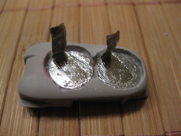

    4. Dexcom G4 Batteries Replacement, Cutting around the batteries: step 4, image 1 of 2 Dexcom G4 Batteries Replacement, Cutting around the batteries: step 4, image 2 of 2
      • Use a 0.5mm cutter and grind around the batteries.
      • Be careful not to grind too deep! This process is only for loosen them and make space for the screwdriver.

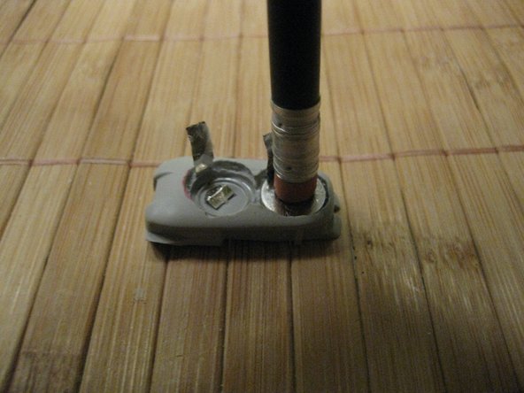

    5. Dexcom G4 Batteries Replacement, Lever the first battery with the screwdriver: step 5, image 1 of 3 Dexcom G4 Batteries Replacement, Lever the first battery with the screwdriver: step 5, image 2 of 3 Dexcom G4 Batteries Replacement, Lever the first battery with the screwdriver: step 5, image 3 of 3
      • The lever part is easy but be careful with the lower contact plates. They are sticking at the (-)pole.
      • Use the edge of the screwdriver and lever it carefully left-right-left ... till it's detached. Then push the contact plate down.

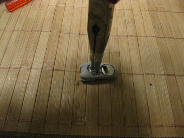

    6. Dexcom G4 Batteries Replacement, The same with the second battery: step 6, image 1 of 3 Dexcom G4 Batteries Replacement, The same with the second battery: step 6, image 2 of 3 Dexcom G4 Batteries Replacement, The same with the second battery: step 6, image 3 of 3
