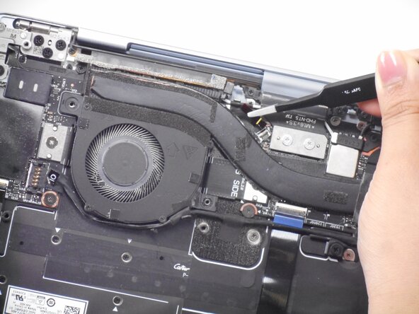

    1. Dell XPS 13 9315 Display Assembly Replacement, Display Assembly: step 8, image 1 of 3 Dell XPS 13 9315 Display Assembly Replacement, Display Assembly: step 8, image 2 of 3 Dell XPS 13 9315 Display Assembly Replacement, Display Assembly: step 8, image 3 of 3
      • The back of the laptop after following the prerequisite guides
      • Locate and unscrew the M1.6x3.5 screws on the LCD display connector.
      • Remove the display assembly interposer board from the system board

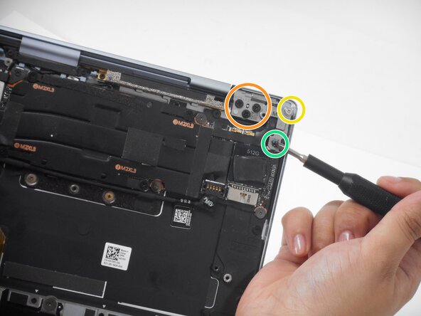

    2. Dell XPS 13 9315 Display Assembly Replacement: step 9, image 1 of 3 Dell XPS 13 9315 Display Assembly Replacement: step 9, image 2 of 3 Dell XPS 13 9315 Display Assembly Replacement: step 9, image 3 of 3
      • Locate the screws on the hinges on both sides of the laptop for removal.
      • Unscrew the six M2.5x4.3 screws on both sides of the laptop.
      • Unscrew the two M1.6x3 screws on both sides of the laptop.
      • Unscrew the two M1.6x2.5 screws on both sides of the laptop.
      • On both sides of the laptop, firmly grip the highlighted area and pull the hinge up to free the display assembly.
