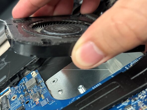

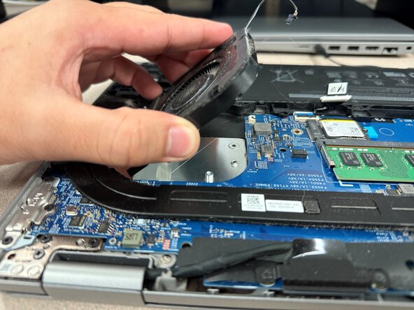

    5. Dell Precision 3580 Fan Replacement: step 5, image 1 of 1
      • Use a JIS #0 screwdriver to loosen the four screws securing the fan.
      Ask FixBot
    6. Dell Precision 3580 Fan Replacement: step 6, image 1 of 2 Dell Precision 3580 Fan Replacement: step 6, image 2 of 2
      • Remove the fan from the laptop.
      Ask FixBot
