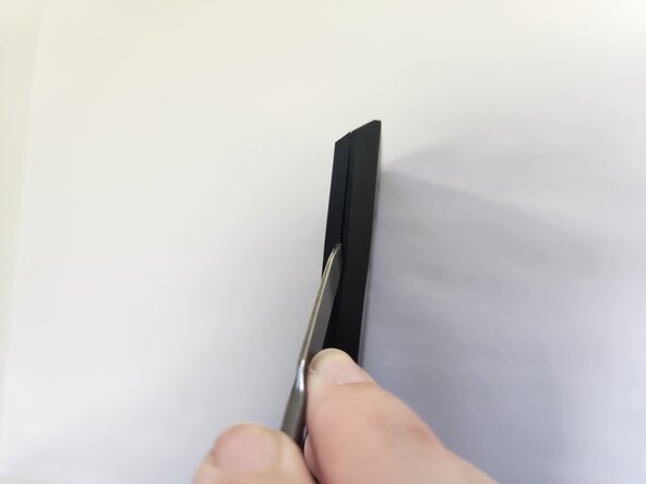

    1. CAT S22 Flip Back Screen Replacement, Back Screen: step 1, image 1 of 3 CAT S22 Flip Back Screen Replacement, Back Screen: step 1, image 2 of 3 CAT S22 Flip Back Screen Replacement, Back Screen: step 1, image 3 of 3
      • Insert a metal spudger into the seam of the phone frame.
      • Apply a downward force on the metal spudger to create a gap.
