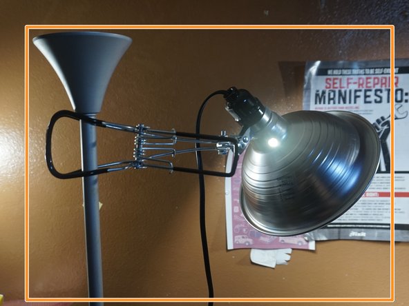

UNLESS you score a deal on these panel lights from a photo studio, eBay (or a classified site), they tend to be significantly more expensive. As such, this guide uses a different setup: 2 >90 CRI LED bulbs and reflector lights. These are not as good as a dedicated LED, but are much cheaper.

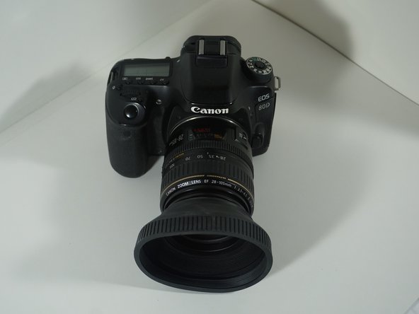

Smartphone: The camera you already have. For the most part, many have cameras which are good enough (or are "P&S quality"). While not as good as a Mirrorless or DSLR camera, image quality is generally good enough.
Mirrorless: These are similar to DSLRs but have fewer moving parts and smaller bodies. These use the same sensors as DSLR cameras, but have different lens mounts. In most cases, older SLR lenses can be used with an adapter (Sony LA-EA, Canon RF>EF, Nikon F>Z).
DSLR: Similar to Mirrorless cameras, but use different lenses and have larger bodies. These still get better battery life compared to mirrorless cameras. It is not uncommon for lenses to be cheaper due to the used market. NOTE: I am showing a prosumer DSLR, but it is not required.

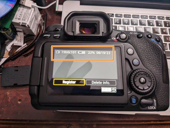

Refer to your camera's menu system to see how to check this as each brand is different. For example, the battery I got with my Canon 80D from 6/2017 is essentially in very poor condition and "end-of-life". I still use it but I do not trust it in the field without a healthy pair of spares.
The seller this 80D came from "included" this battery, but likely knew it was nearing the end of it's usable life. I cannot verify this as absolute fact, but this is VERY common with used cameras.

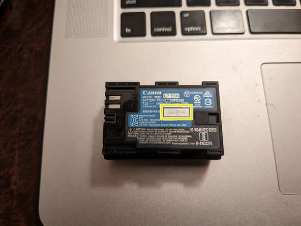

Batteries without monitoring: If your battery has no/poor monitoring, look for a date stamp. If it is over 3 years old WITH limited runtime, consider it consumed.

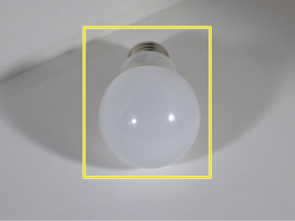

CFL (AVOID): Avoid using CFLs, even on clearance. They are not as bright as LEDs, take time to warm up and contain mercury (disposal is hard). They also tend to fail young due to cheap ballasts and components that do not get along with heat.

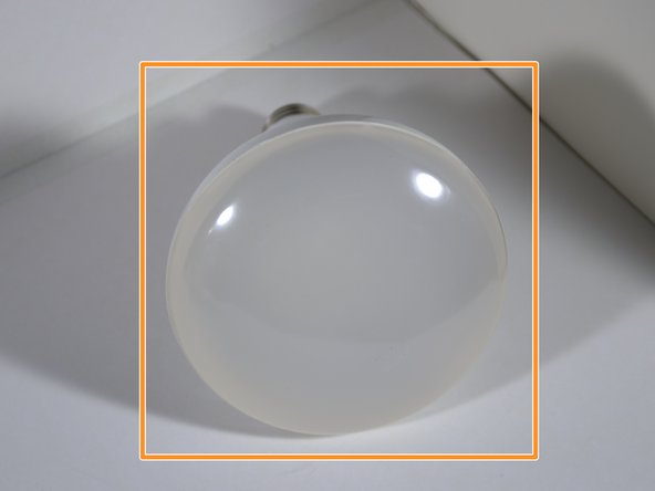

BR30/40: These produce a focused beam of light which can result in better photos compared to omnidirectional bulbs. These bulbs must be used in a specific direction by design.
A19: While these work the light can be somewhat unbalanced or scattered without redirection. You must use a minimum of 100W for good photo lighting.

Standing lamp: Space may be an issue with lamps that have a base, but if you can make this work a broken lamp (with the cord and socket removed) can be used.

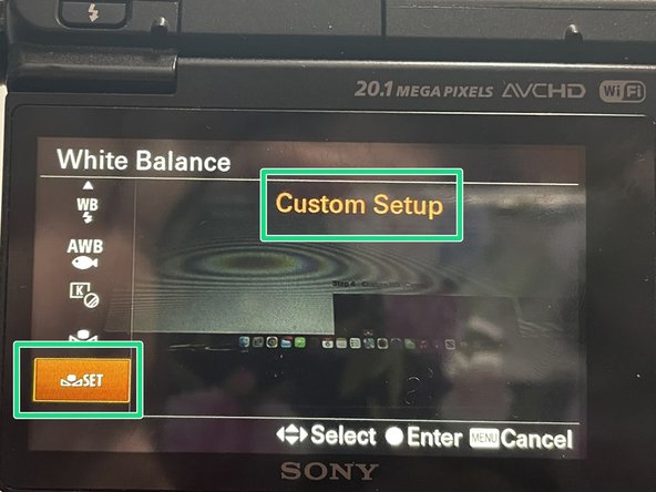

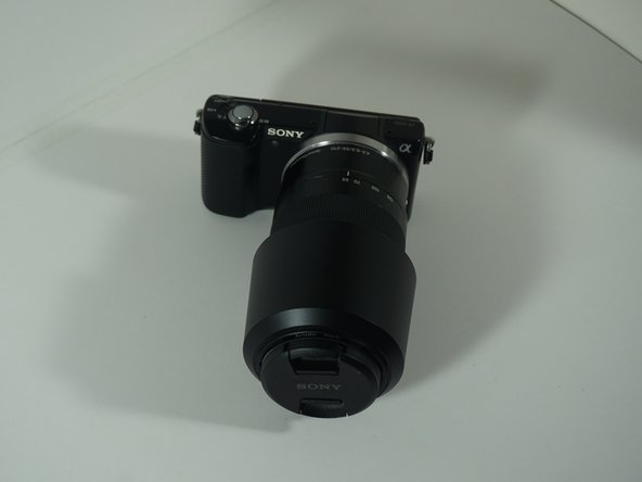

Sony: Sony a5X000 (SW driven) Sony Alpha (Advanced, a6X00 and up) Sony NEX (FOR NEX-5N; NOT CHECKED)
Switch the camera into a Manual mode (P/A/S/M; doesn't matter). You MUST be in a "manual" mode to use custom WB settings.
Open the menu and select the following: Camera settings>White Balance.
NOTE: The location of the white balance setting varies from camera to camera. Keep this in mind if you do not see the setting as shown in my demo a6000. (Ex: a6000 is Line 4, a6100 is under Line 9 and a6300 is under Line 5.
Select the White Balance option, and scroll down until you see Custom Setup. Take a picture of your lighting setup and press the Enter button to save it to the camera.

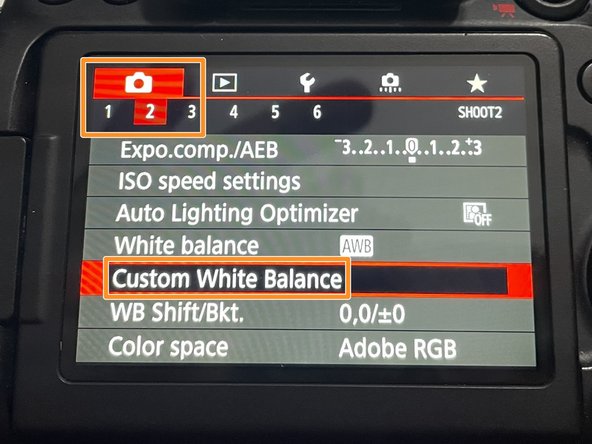

Put the camera in one of the 4 manual modes (P/A/S/M). Select the red menu (Menu 2), then select Custom white balance.
Select the white reference photo. Press SET on the camera. Once this is done, the camera will save the custom white balance.

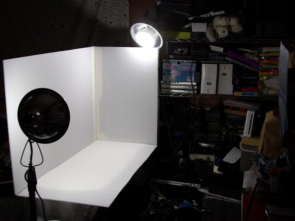

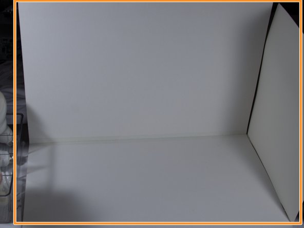

Setup a backdrop support. This can be anything from a trifold board cut in half (the style you used in "school") or a custom design. I chose a custom design to conform it to my design spec and make the modifications I wanted.
Setup your white background. Once the backdrop is stable, minimize as many unsightly areas as possible. You are ready.
Take a few test photos (Optional). If you are unsure about the end result, take 1-2 test shots for review. Make adjustments until you are happy with the end result.

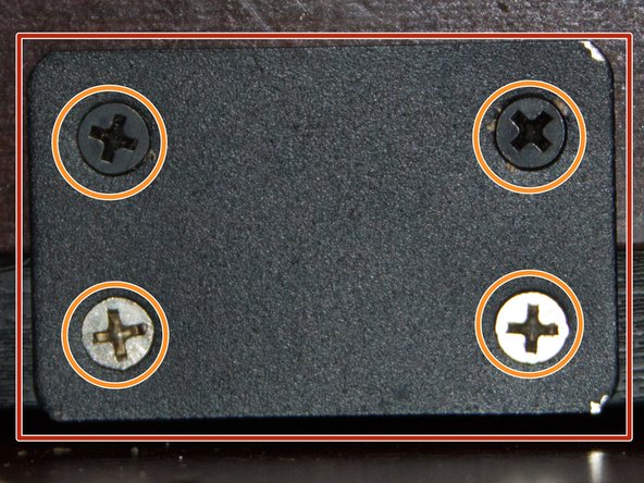

Place a few support brackets on the lower piece. Add screws as your brackets permit.
Hold the top piece up and add screws to the top side.
Once assembled, you are ready to use the backdrop.

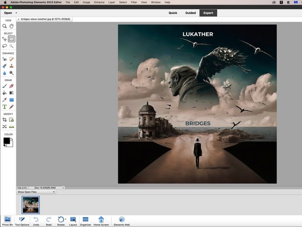

Photoshop Elements (Paid): For most people, this is sufficient but with limitations NOT FOUND in CC/Legacy CS: Advanced functions are automatic only and only supports RGB/8/16* (*downgrades to RGB/8). HDR RGB/32 support is limited to JPG files. While it "works", there are restrictions not found in other programs or CC.
