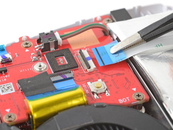

  10. Asus ROG Ally Left Thumbstick Replacement, Disconnect the left thumbstick ring: step 10, image 1 of 3 Asus ROG Ally Left Thumbstick Replacement, Disconnect the left thumbstick ring: step 10, image 2 of 3 Asus ROG Ally Left Thumbstick Replacement, Disconnect the left thumbstick ring: step 10, image 3 of 3
    • Use the point of a spudger to lift the locking flap on the left thumbstick ring ZIF connector.
    • Use tweezers to grip the cable's blue pull tab and pull the connector straight out of its socket.
    • The black line on the ZIF connector cables mark the connection area. During reassembly, insert the cables into their sockets up to this line.

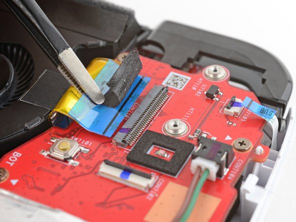

  11. Asus ROG Ally Left Thumbstick Replacement, Peel up the main board interconnect cable tape: step 11, image 1 of 2 Asus ROG Ally Left Thumbstick Replacement, Peel up the main board interconnect cable tape: step 11, image 2 of 2
    • Use tweezers to peel up the tape covering the main board interconnect cable ZIF connector.
  12. Asus ROG Ally Left Thumbstick Replacement, Disconnect the main board interconnect cable: step 12, image 1 of 3 Asus ROG Ally Left Thumbstick Replacement, Disconnect the main board interconnect cable: step 12, image 2 of 3 Asus ROG Ally Left Thumbstick Replacement, Disconnect the main board interconnect cable: step 12, image 3 of 3
    • Use the flat end of a spudger or clean fingernail to lift the locking flap on the main board interconnect cable ZIF connector.

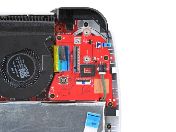

  13. Asus ROG Ally Left Thumbstick Replacement, Unfasten the left thumbstick assembly: step 13, image 1 of 3 Asus ROG Ally Left Thumbstick Replacement, Unfasten the left thumbstick assembly: step 13, image 2 of 3 Asus ROG Ally Left Thumbstick Replacement, Unfasten the left thumbstick assembly: step 13, image 3 of 3
    • Use a Phillips #00 screwdriver to remove the four 3.4 mm‑long screws securing the left thumbstick assembly.
    • During reassembly, keep the right edge of your device lifted while you tighten the screws so the thumbstick doesn't press against your work surface and pop out of place.
  14. Asus ROG Ally Left Thumbstick Replacement, Remove the left thumbstick assembly: step 14, image 1 of 3 Asus ROG Ally Left Thumbstick Replacement, Remove the left thumbstick assembly: step 14, image 2 of 3 Asus ROG Ally Left Thumbstick Replacement, Remove the left thumbstick assembly: step 14, image 3 of 3
    • Insert the flat end of a spudger between the bottom right edge of the thumbstick assembly and the chassis.
    • Pry up the thumbstick assembly and remove it.

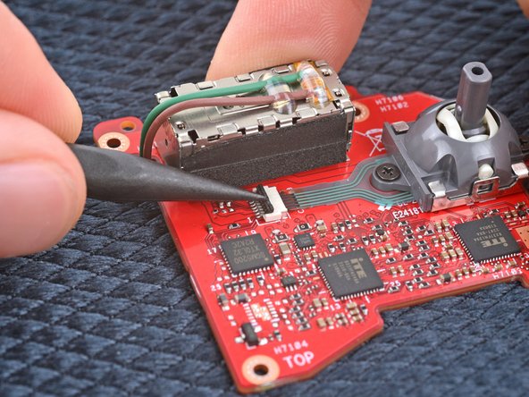

  17. Asus ROG Ally Left Thumbstick Replacement, Lift the left thumbstick locking flap: step 17, image 1 of 2 Asus ROG Ally Left Thumbstick Replacement, Lift the left thumbstick locking flap: step 17, image 2 of 2
    • Use the point of a spudger to lift the locking flap on the thumbstick ZIF connector.
  18. Asus ROG Ally Left Thumbstick Replacement, Unfasten the left thumbstick: step 18, image 1 of 2 Asus ROG Ally Left Thumbstick Replacement, Unfasten the left thumbstick: step 18, image 2 of 2
    • Use a Phillips #00 screwdriver to remove the two 3.4 mm‑long screws securing the thumbstick.
  19. Asus ROG Ally Left Thumbstick Replacement, Remove the left thumbstick: step 19, image 1 of 2 Asus ROG Ally Left Thumbstick Replacement, Remove the left thumbstick: step 19, image 2 of 2
    • Grab the thumbstick with your fingers and gently pull the cable out of its socket.
    • You're now left with the thumbstick and thumbstick board on their own.
    • After reassembling your device, follow this guide to calibrate your new thumbstick.
