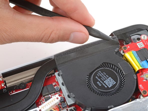

  9. Asus ROG Ally Heatsink Replacement, Separate the fan tape: step 9, image 1 of 3 Asus ROG Ally Heatsink Replacement, Separate the fan tape: step 9, image 2 of 3 Asus ROG Ally Heatsink Replacement, Separate the fan tape: step 9, image 3 of 3
    • Two pieces of tape secure the upper edges of the fans to the heatsink foam.
    • Insert the point of a spudger between the tape on the upper edge of one of the fans and the heatsink foam.
    • Slide the spudger under the length of the tape to separate it from the foam.
  10. Asus ROG Ally Heatsink Replacement: step 10, image 1 of 3 Asus ROG Ally Heatsink Replacement: step 10, image 2 of 3 Asus ROG Ally Heatsink Replacement: step 10, image 3 of 3
    • Repeat the previous step to separate the other piece of fan tape.
    • During reassembly, firmly press both pieces of tape back onto the foam.
