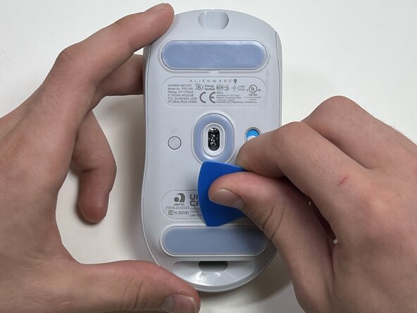

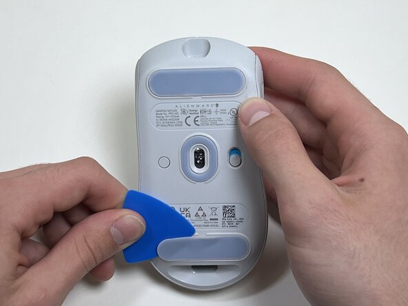

    1. Alienware Pro Wireless Gaming Mouse Side Button Replacement, Feet: step 1, image 1 of 3 Alienware Pro Wireless Gaming Mouse Side Button Replacement, Feet: step 1, image 2 of 3 Alienware Pro Wireless Gaming Mouse Side Button Replacement, Feet: step 1, image 3 of 3
      • Flip the mouse over so the bottom is facing up..
      • Use an opening pick to gently peel the mouse foot off the bottom case.
      • The mouse feet warp easily so if you're not replacing them, be careful and don't rip them off. You will need them when you reassemble the mouse.

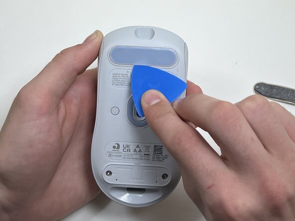

    2. Alienware Pro Wireless Gaming Mouse Side Button Replacement: step 2, image 1 of 2 Alienware Pro Wireless Gaming Mouse Side Button Replacement: step 2, image 2 of 2
      • Peel and remove the other mouse foot.

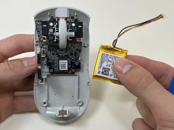

    4. Alienware Pro Wireless Gaming Mouse Side Button Replacement: step 6, image 1 of 2 Alienware Pro Wireless Gaming Mouse Side Button Replacement: step 6, image 2 of 2
      • The battery is glued to the case.
      • Use an opening tool or spudger to loosen the adhesive under the battery.
      • Remove the battery.

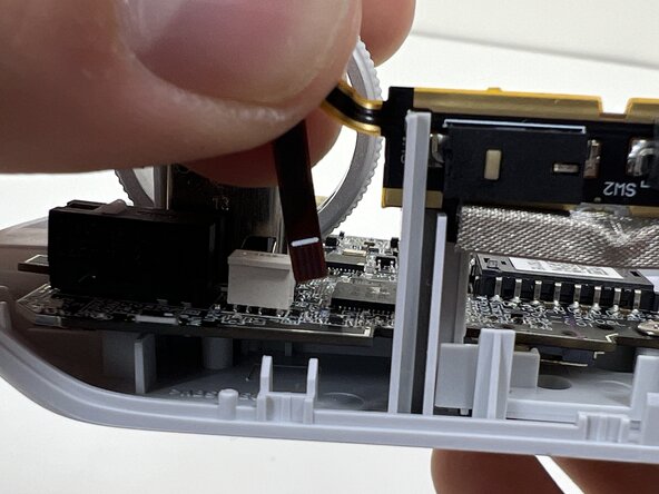

    1. Alienware Pro Wireless Gaming Mouse Side Button Replacement, Side Button: step 7, image 1 of 2 Alienware Pro Wireless Gaming Mouse Side Button Replacement, Side Button: step 7, image 2 of 2
      • Pinch the upper part of the ribbon cable.
      • Pull the ribbon cable gently to detach it from the socket on the motherboard.
      • Make sure the ribbon line is facing the correct direction when reassembling the controller.
