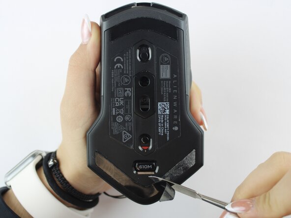

    2. Alienware AW610M Side Button Replacement: step 2, image 1 of 2 Alienware AW610M Side Button Replacement: step 2, image 2 of 2
      • Use a spudger to gently lift and remove the old mouse feet.
      • If the feet are sticky, try lifting slowly from one corner to avoid tearing them.
      • Be careful not to scratch the mouse surface or damage the plastic housing.

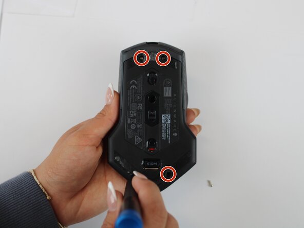

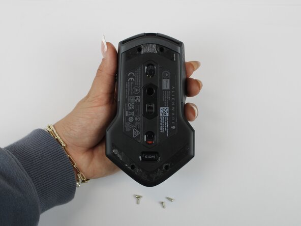

    3. Alienware AW610M Side Button Replacement: step 3, image 1 of 2 Alienware AW610M Side Button Replacement: step 3, image 2 of 2
      • Remove the four 6.5 mm screws using a Y1 Tri-Point screwdriver.
      Ask FixBot

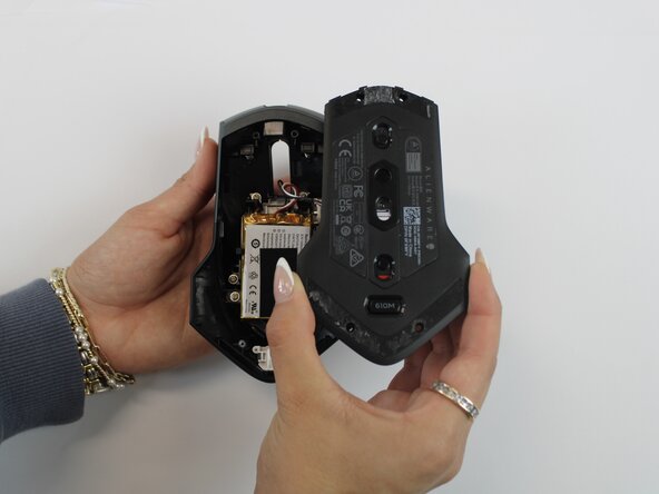

    5. Alienware AW610M Side Button Replacement: step 5, image 1 of 3 Alienware AW610M Side Button Replacement: step 5, image 2 of 3 Alienware AW610M Side Button Replacement: step 5, image 3 of 3
      • Remove the battery pack inside the mouse.
      • If you are having trouble, use a small flat tool to help ease it out.
      • The battery is lightly glued to the mouse, so ease it out gently to avoid breaking the battery or wiring
      Ask FixBot

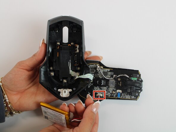

    6. Alienware AW610M Side Button Replacement: step 6, image 1 of 2 Alienware AW610M Side Button Replacement: step 6, image 2 of 2
      • Remove the old battery from its spot. Lift the wire connector away from the mainboard to disconnect it.
      • Make sure all wires are inside the mouse before sealing it shut for easy reassembly.
      Ask FixBot

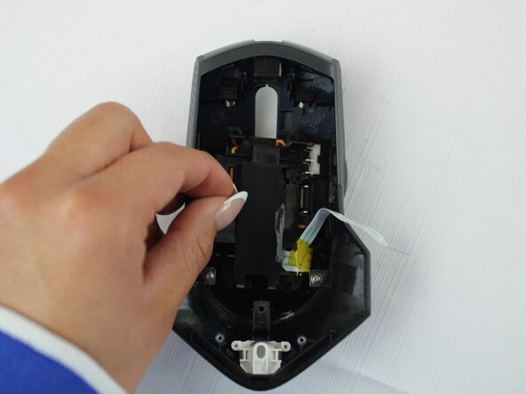

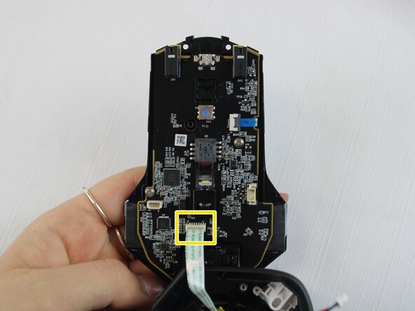

    1. Alienware AW610M Side Button Replacement, Side Button: step 7, image 1 of 2 Alienware AW610M Side Button Replacement, Side Button: step 7, image 2 of 2
      • Remove the single 5.4 mm screw using a Phillips #1 screwdriver.
      • Detach the cable connector, and remove the scroll wheel.
      • Gently detach the last connector using your fingers.
      • Be careful when unplugging all connectors to prevent tearing them.
      Ask FixBot

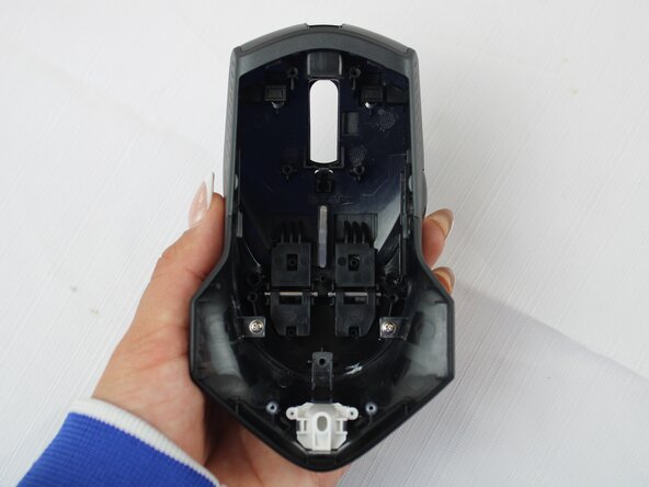

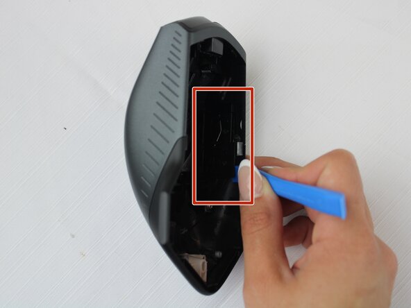

    3. Alienware AW610M Side Button Replacement: step 9, image 1 of 2 Alienware AW610M Side Button Replacement: step 9, image 2 of 2
      • Using your fingers, disconnect the plastic tab in the middle of the large shell casing to access the side buttons.
      Ask FixBot

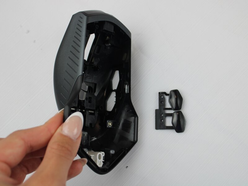

    4. Alienware AW610M Side Button Replacement: step 10, image 1 of 3 Alienware AW610M Side Button Replacement: step 10, image 2 of 3 Alienware AW610M Side Button Replacement: step 10, image 3 of 3
      • Remove the side button on the inner side of the wall using a plastic opening tool.
      • Be gentle prying the side buttons off to avoid breaking them.
      • When reassembling, position the new side button assembly into the slot, aligning it with tabs. Snap it securely into place using a plastic opening tool or your fingers.
