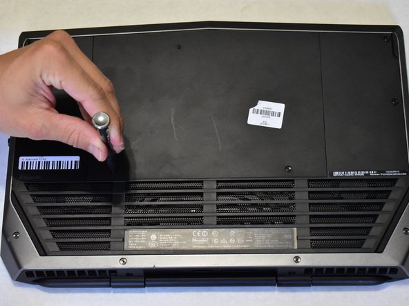

      • Place the laptop upside down with the hinge facing you. Using the Phillips #0 screwdriver, remove the two 9 mm screws located in the top left and right of the rear panel.
      • Remove the rear panel by using the iFixit opening tool to separate it from the back of the laptop.
      • Remove the four 18 mm screws with a Phillips #0 screwdriver.
      • Remove the four 10 mm screws with a Phillips #0 screwdriver.
