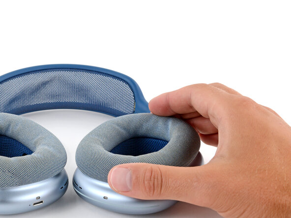

    1. AirPods Max Left Microphone Replacement, Remove the left earpad: step 2, image 1 of 2 AirPods Max Left Microphone Replacement, Remove the left earpad: step 2, image 2 of 2
      • The earpads are secured with magnets.
      • Lift the left earpad (labeled L) straight up and remove it.

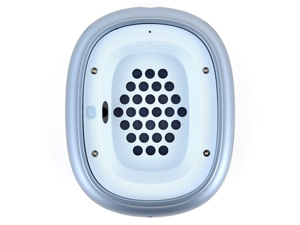

    2. AirPods Max Left Microphone Replacement, Turn the housing screws to the open position: step 5, image 1 of 2 AirPods Max Left Microphone Replacement, Turn the housing screws to the open position: step 5, image 2 of 2
      • Turn these screws slowly and gently, stopping when you feel resistance—about 1/4 turn. If turned too far, the locking mechanism will break.
      • Use a P5 pentalobe screwdriver to turn (not remove) the four speaker housing screws to the unlocked position:
      • Turn the top left and bottom right screws counterclockwise.
      • Turn the top right and bottom left screws clockwise.
      Ask FixBot

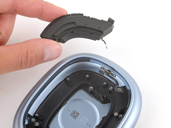

    5. AirPods Max Left Microphone Replacement: step 8, image 1 of 3 AirPods Max Left Microphone Replacement: step 8, image 2 of 3 AirPods Max Left Microphone Replacement: step 8, image 3 of 3
      • Don't try to fully remove the speaker housing yet—a delicate ribbon cable still connects it to the ear cup.
      • Lift the speaker housing out of the ear cup to fully separate the remaining adhesive.
      • Flip the housing over the side of the cup and prop it up so you can access the cable.
      Ask FixBot

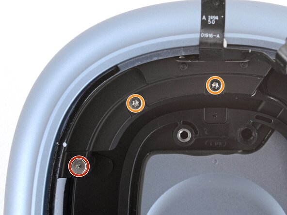

      • Don’t let any screws snap onto the speaker driver diaphragm or they'll damage it. The screws will be drawn towards the center by the speaker's magnet.
      • Remove the four screws securing the cable cover:
      • One 7.5 mm‑long Torx Plus 3IP screw
      • Three 1.7 mm‑long Torx Plus 1IP screws
      Ask FixBot

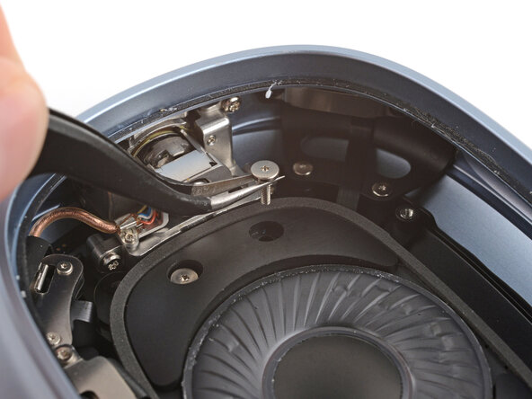

    1. AirPods Max Left Microphone Replacement, Remove the speaker driver screws: step 13, image 1 of 3 AirPods Max Left Microphone Replacement, Remove the speaker driver screws: step 13, image 2 of 3 AirPods Max Left Microphone Replacement, Remove the speaker driver screws: step 13, image 3 of 3
      • Grip the screws with tweezers while loosening and removing them. Don’t let the screws snap onto the diaphragm.
      • Use a Torx Plus 3IP screwdriver to remove three speaker driver screws:
      • Two 6.0 mm‑long screws
      • One 6.0 mm‑long screw that's slightly thicker than the other two
      • Remove the 5.1 mm‑long standoff screw using one of the two methods below:
      • Apply constant downward force to avoid damaging the screw.
      • Option 1: Stick a small flathead screwdriver into one of the four notches on top of the screw and use it to slowly turn the screw.
      • Option 2: Use a Torq-Set 6 screwdriver to remove the screw, applying constant downward force to avoid damaging the screw.

    6. AirPods Max Left Microphone Replacement, Turn the housing screws to the closed position: step 53, image 1 of 2 AirPods Max Left Microphone Replacement, Turn the housing screws to the closed position: step 53, image 2 of 2
      • Use a P5 pentalobe screwdriver to turn the four speaker housing screws to the locked position:
      • Turn the top left and bottom right screws clockwise.
      • Turn the top right and bottom left screws counterclockwise.
