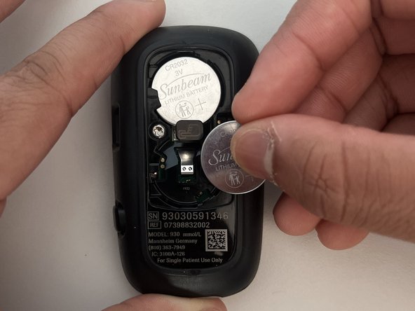

    3. Accu-Chek Guide Diabetes Meter Battery Replacement: step 3, image 1 of 3 Accu-Chek Guide Diabetes Meter Battery Replacement: step 3, image 2 of 3 Accu-Chek Guide Diabetes Meter Battery Replacement: step 3, image 3 of 3
      • Use a plastic spudger near the middle right side of the top 3V battery to pry it from the battery holder.
      • Press down on the middle of the battery holder to eject the bottom battery.

    4. Accu-Chek Guide Diabetes Meter Battery Replacement: step 4, image 1 of 2 Accu-Chek Guide Diabetes Meter Battery Replacement: step 4, image 2 of 2
      • Slide the new 3V battery in the top slot, then press down to secure it in place.
      • Replace the 3V battery in the bottom slot.
      • The plus sign on the 3V batteries should face down when placed in each slot.

Text says "2016" batteries. Photograph shows 2032 batteries ! ! !
Janet Appleby - Reply Share
Hi Janet, thank you so much for letting us know about the incorrect batteries in the parts list. We’ve updated it, and we really appreciate your help in keeping the guide accurate.
