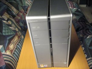

The Sony Vaio PCV-RZ14G is a desktop tower computer designed for home use. This model is sold as part of Sony’s Vaio line of desktop computers. Sony today sells numerous consumer electronics, including televisions, cameras, home appliances, and, of course, desktop computers. Sony has produced numerous desktop computers over the years. Sony’s early desktops, the Vaio Series, were originally announced in 1996. These devices were well known for pushing the bounds of consumer electronics and offering innovative technology.
The Sony Vaio PCV-RZ14G features an Intel Pentium 4 processor with a SiS651 chipset. The processor features a 512 KB cache. The computer has 512 MB of RAM with a memory speed of 266 MHz. The tower computer includes CD-ROM storage and an HDD storage device with a maximum capacity of 120 GB. The PCV-RZ14G model has a 3.5-inch 1.44 MB floppy disk drive. This computer features an NVIDIA GeForce MX 440 graphics processor with 64 MB of video memory. It runs on the Microsoft Windows XP Home Edition operating system.
Sony desktop computers are either all-in-one PCs or tower PCs for use with an external monitor. Sony desktop computers house internal computer components in an encasing, which is either integrated with the display or in a separate box-like tower. Sony desktop PCs have the Sony logo printed somewhere on the device.
