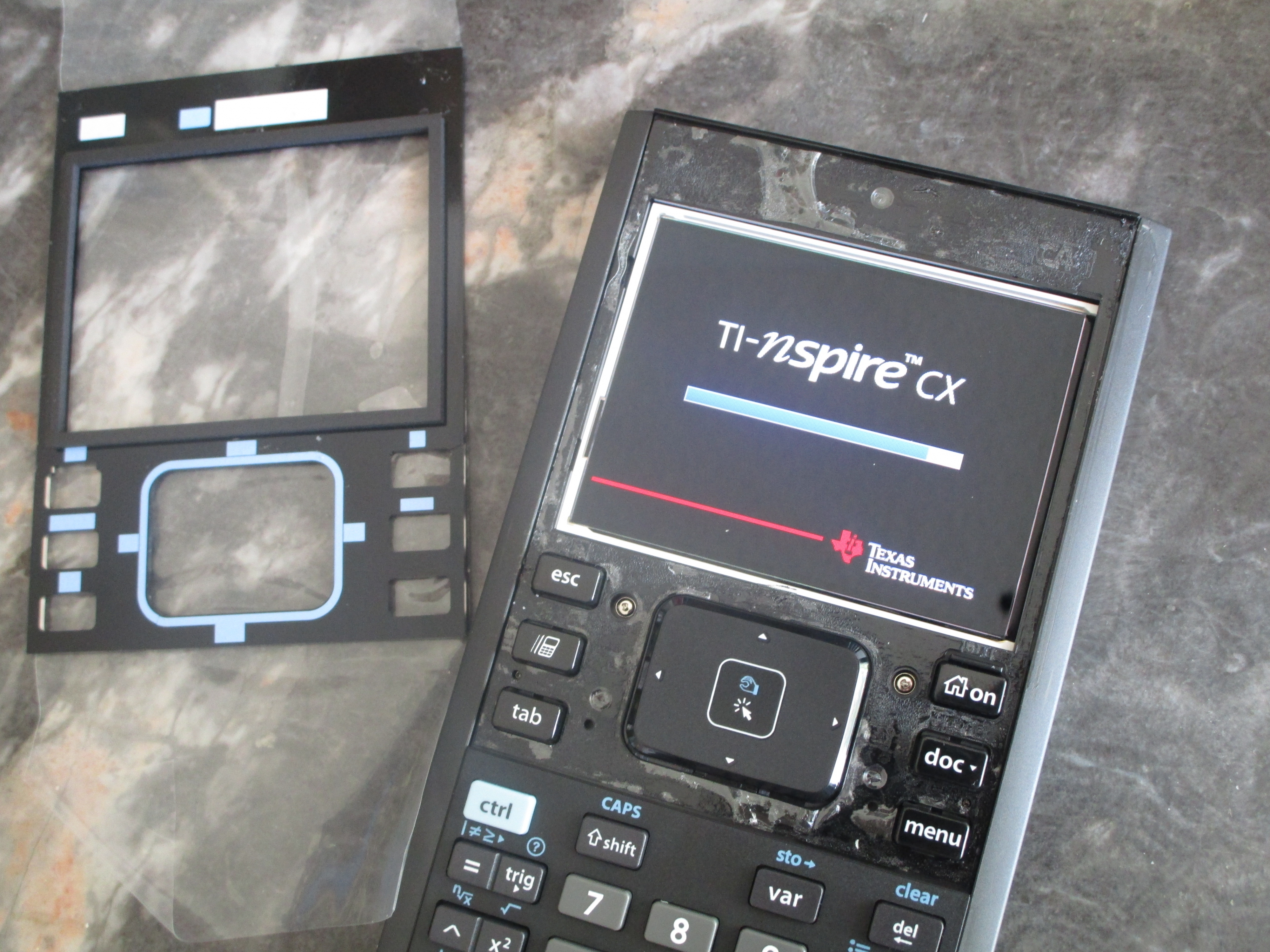

I have these two nspire cx II -T , one with cas, one without. I have trouble with dissassembly them.. i cant get the front panel loose. Anyone who can help me out with this problem?

Unfortunately the Nspire CX family is horrible to disassemble.
  1. Remove all the screws on the back. They're Torx T6 and Phillips.
  2. You need to carefully heat up the glossy plastic bezel to soften the glue underneath (unfortunately I don't have an exact temperature. Be careful you don't start melting the plastic)
  3. Then you need to very carefully bend the plastic bezel away to access the two screws hidden underneath. Be careful not to snap or warp the plastic while taking it off.
  4. This will reveal two screws near the TouchPad.
  5. Here's what it should look like. (Image from tiplanet.org, a French calculator community)
  6. Once those two screws are remove you can start prying the two halves of the calculator apart.
These calculators are so difficult to disassemble that TI will drill holes in the front bezel of their prototypes to access the screws easier.

Thank you for reply 😊I have had the calculator at a mobilephone repair shop. They did try to heat this up and remove it to access the last two screws, they told me that there was no glue there after they had tried to heat it and remove it. They also said that the front panel itself started to lift up when they tried to remove the plastic bezel.
