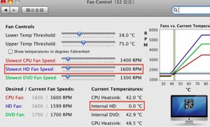

replace the hard drive, how do I connect Hard Drive thermal sensor?
My iMac's (i3 ,WD 500G ) Hard Drive is failure and I replace a new one but I can't connect thermal sensor to new Hard Drive because the connectors are different.
So my Hard Drive Fan will run the full speed after 10 mins when I power on.
I google the solution and someone suggest that I can jump the connector to make the sensor short then it will show 0 C degree.
It works but I afraid the Hard Drive will overheat when I use for a long time.
Do you have any solution to solve this problem?
Thank you.

The best solution, is using a Transistor 2N3904. Just remove the connector (side HD) and solder a 2N3904. Gray wire on E (Transistor) and black wire on BC (transistor).
By Alexandre Larangeira

I see this thread has been going for some time and it is the best one I found on the Internet so far. I purchased a new SSD drive for my late 2009 27" iMac and before I dismantle everything, I would like to be prepared for all operations in advance. This includes replacing the HDD by a SSD but also deal with the Thermal sensor issue.
I find Alexandre's answer to use a 2N3904 transistor simple and interesting and would like to know a little more about it, so please allow me to ask a few questions:
1. Has this solution been tested and validated by anyone?
2. If so, does this setup provide a temperature reading when using a tool such as MacsFanControl or iStat Pro?
3. Does the reported temperature (and variation) make sense?
4. Does this solution allow HDD Fan to behave normally - without any additional software control (ie. not spin at max speed at startup and increase speed reasonably if temperature goes up)?
If this solution has not proven to work, I will most certainly just jump the connector, but will then have a zero reading for that sensor :-(
Thanks in advance
Was this answer helpful?
Score 3
12 Comments:
Marc66,
1 - Already applied my solution in over 50 iMacs
2 - yes, this transistor acts as a temperature sensor
3 - normal
4 - Yes, it works the same way as the original hd
5 - works perfectly

I know this is an older thread, but here's something I've found. If you're replacing a WD drive, you need to rotate the temp sensor connector 180º when connecting it to the new drive, so the dark cable is closest to the drive's PCB.
1 2 3 4
• • D • |DATA||POWER|
• • L •
5 6 7 8
This will fix the issue of the fans spinning up after a few minutes (technically, because the "HDD Proximity" sensor data was out of tolerance).

Great thread - very informative! I used an eBay sourced optical drive sensor (transistor type) from a different iMac and taped it to my new hard disk. These seem to be less expensive on eBay than those sold as HDD temp sensors. Worked perfectly with no need for additional software.

Hi my friend! Of course the drive failed because of the bad construction of cooling in these desktops.I cant understand what Apple thinking when was making these all in one machines..Maybe is only for Antarctica? :) I have seen temps in hard drives more than 50c and continiously..They cant last like that..The most is 37c at continuous operation..Of course Western digital hd's can last longer than any brand( not the blue).
The only solution is to install a third party software to control fans and the only one that is working as i said some months ago is : http://www.derman.com/iMac-Fan-Control
Dont search anything else is not working like this at least for my mac.
then join the two point connector together itsself. The next thing is to put the hard drive outside the aluminium case and put an fan from desktop tower on it with a case for external drive and then your hd will be work at most in 32c.
That's it.
