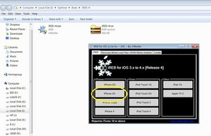

Good you have made progress, don't give up now. Error 1601 is caused when iTunes recognizes a customised IPSW file. So what you need to perform first is while your phone is in DFU mode and connected to your PC run iREB-r4
Download from here
http://dl.dropbox.com/u/55495998/iREB-r4...
once run press the corresponding button for your phone. So you would press 3G,
and then iREB will put your phone into a PWNED state. You should see the same screens as in my screenshots below. The only difference is that I was using my iPhone 4 and you have a 3G.
This will make "decieve" iTunes into allowing the installation of a modified IPSW.
If iTunes throws the same error, then run iREB again.
Good luck.
