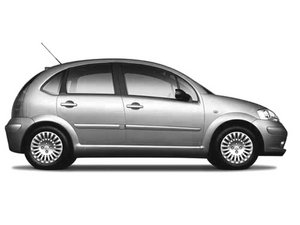

First generation of Citroen's supermini car.
How to remove the eco mode
The car is stock on the eco mode and it can be removed.
