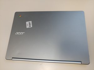

SSD upgrade or change?
Can i upgrade or change SSD ? M.2 format ? mSATA ?

This system uses a soldered on flash drive on the logic board and is not replaceable.

One can also use a pre-flashed SD card, or maybe even usb-to-nvme adapters, and load the operating system that way. Please review this documentation:
https://github.com/hexdump0815/linux-mai...
https://archlinuxarm.org/platforms/armv8...
I'm currently using this Chromebook with Debian and ChromeOS dualbooted. Note, the SD card should be a high-endurance one like A2, which is made for applications and often utilization.
