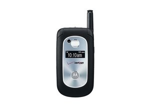

The Motorola V325 is a clam shell phone, featuring VZ Navigator.
How do I fix a broken hinge spring?
I need to know how to repair a broken hinge spring. Phone works fine, but front display half of the phone kind of flops around.
