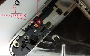

sensor not work after replacing digitizer and LCD
the sensor not work
when i put the broken lcd its work well

this is a common problem, the best thing to try is take a black piece electrical tape and cut 2 small holes in it to fit over the proximity and ambilight sensor. works 99/100
Was this answer helpful?
you can do the tape with the 2 holes or you can just put tape between the 2 sensors.
