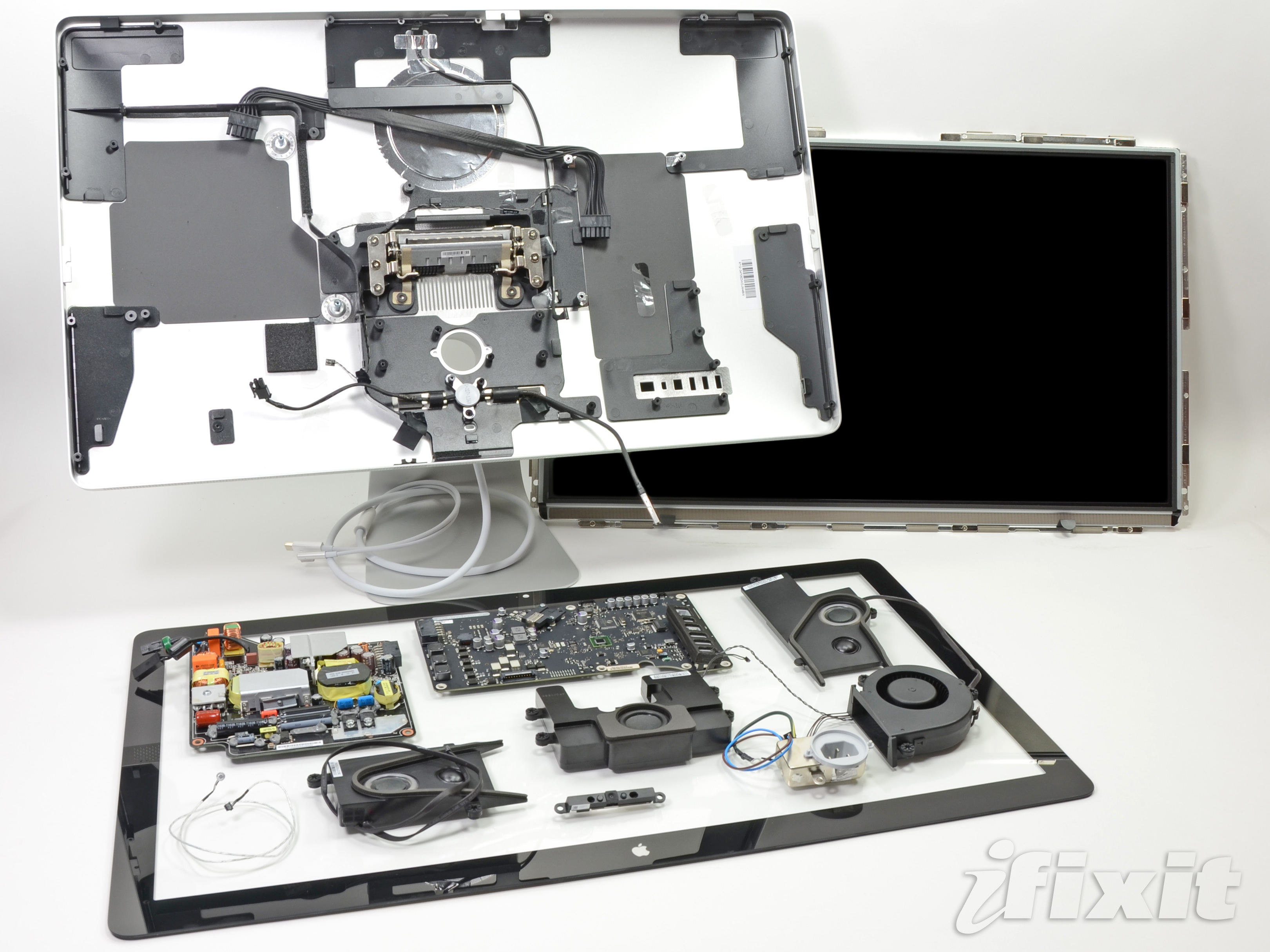

    • Great Odin's Raven! With that old, crappy LCD removed (who needs it anyway), we get a full frontal view of the Thunderbolt Display's inner layout.
    • Where to start . . . the fan you say? Sounds good to us.

    • With the logic board removed, we move on to the power supply board.
    • A few screws and connectors are all that are stopping us from removing the board.
    • We make quick work of them and the Flextronics power supply board comes free.
  14. Apple Thunderbolt Display Teardown: step 14, image 1 of 2 Apple Thunderbolt Display Teardown: step 14, image 2 of 2
    • Hot pot of coffee! Let's see what the Thunderbolt Display's power supply board can do for us.
    • How about 250 watts of maximum continuous power -- is that enough for you?

    • We see some fairly large speaker enclosures (well, for a monitor) near the side edges of the Thunderbolt Display and eagerly remove the screws holding them in place.
    • Wait! What have we here? Is that a built-in 1-inch subwoofer, as well?
    • The Thunderbolt Display comes with a 49 watt 2.1-speaker sound system, including a miniature subwoofer.

    • A couple screws and a single connector keep the HD FaceTime camera secured to the case.
    • Yoink! Out comes the camera and its ability to record video up to 720p, as well as its ability to support widescreen 16 x 9 aspect ratios.
