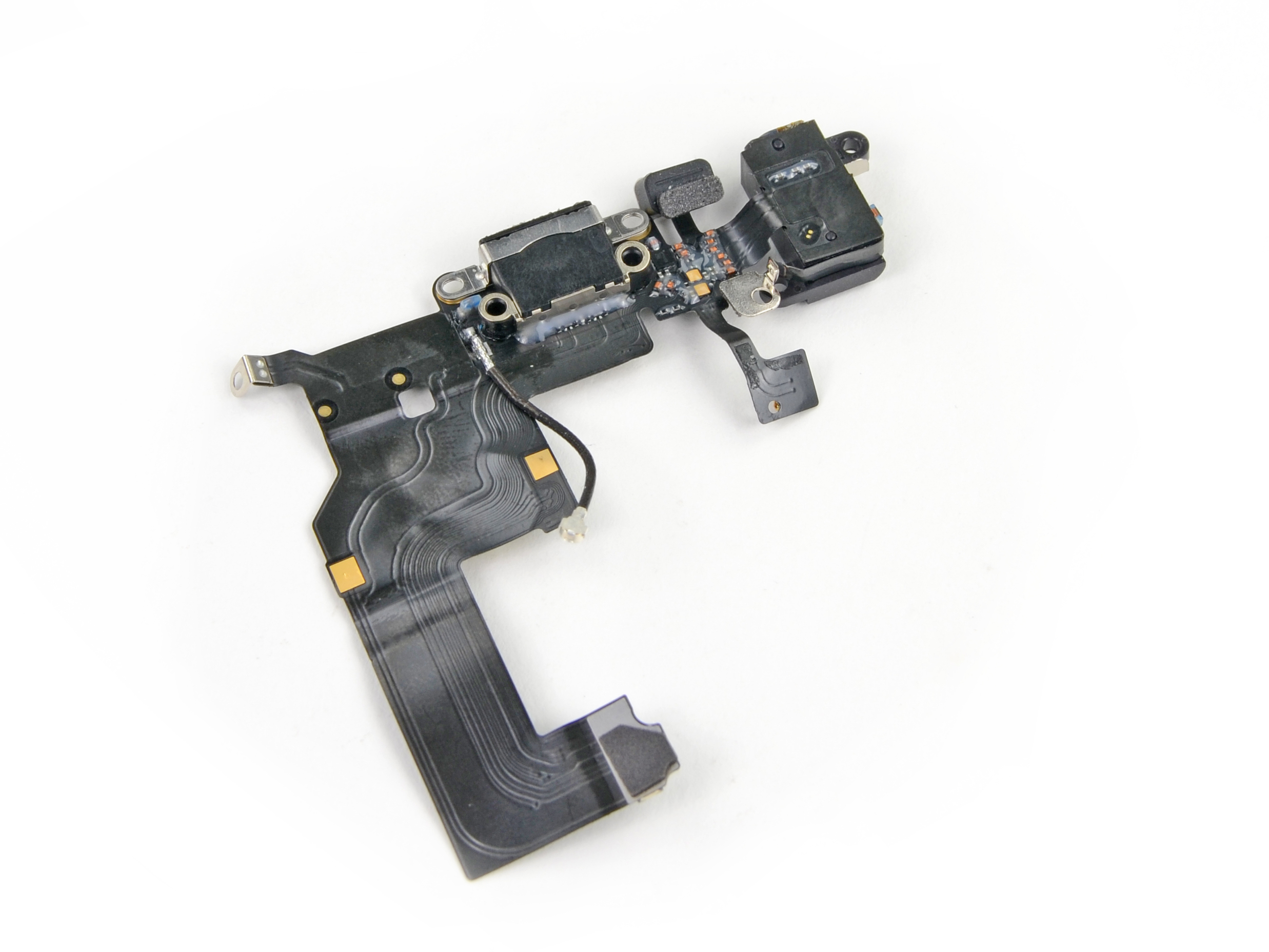

  22. iPhone 5 Lightning Connector and Headphone Jack Replacement, Lightning Connector and Headphone Jack: step 22, image 1 of 1
    • Remove the following screws securing the Lightning connector assembly to the rear case:
    • One 2.9 mm Phillips screw
    • During re-installation, make sure that the headphone jack's plastic protrusion lies above the metal washer.
    • One 1.5 mm Phillips screw
    • Two 3.3 mm Phillips screws
  23. iPhone 5 Lightning Connector and Headphone Jack Replacement: step 23, image 1 of 2 iPhone 5 Lightning Connector and Headphone Jack Replacement: step 23, image 2 of 2
    • Use the opening tool to pry up and disconnect the Lightning connector cable connector from its socket on the logic board.
  24. iPhone 5 Lightning Connector and Headphone Jack Replacement: step 24, image 1 of 1
    • Flip the phone face up, heat an iOpener, and apply it to the right edge of the phone for a minute.
  25. iPhone 5 Lightning Connector and Headphone Jack Replacement: step 25, image 1 of 3 iPhone 5 Lightning Connector and Headphone Jack Replacement: step 25, image 2 of 3 iPhone 5 Lightning Connector and Headphone Jack Replacement: step 25, image 3 of 3
    • Slide an opening pick underneath the Lightning connector flex cable to loosen it from the logic board and the rear case.
  26. iPhone 5 Lightning Connector and Headphone Jack Replacement: step 26, image 1 of 2 iPhone 5 Lightning Connector and Headphone Jack Replacement: step 26, image 2 of 2
    • Use the flat end of a spudger to loosen the rest of the Lightning connector assembly from the rear case.
  27. iPhone 5 Lightning Connector and Headphone Jack Replacement: step 27, image 1 of 3 iPhone 5 Lightning Connector and Headphone Jack Replacement: step 27, image 2 of 3 iPhone 5 Lightning Connector and Headphone Jack Replacement: step 27, image 3 of 3
    • Angle the Lightning connector assembly and pull it out of its recess.
    • Remove the four metal washers and set them aside for reassembly.
    • Before reassembly, use the opening tool or the flat end of a spudger to remove all adhesive residue from the rear case. You can use high-concentration isopropyl alcohol to help with the stubborn spots.

Just a quick note that if you're doing this teardown because your iPhone 5 isn't charging unless you apply some force to the Lightning cable, the problem may simply be some lint or other crud in the Lightning port. Blow some compressed air in there before you disassemble your iPhone and see if it solves the problem - it did for me.
Adam Engst - Reply
ifixed my i5 by cleaning the port too (was just about to buy the kit!). I found a paper clip done the job perfectly.
Cheers, Adam Engst.
Abdul Ali -
Also found dirt was the only fault with a number of 5's.
Gary -
Well I bought the replacement first and then realized about the dirt. I removed the dirt and it is now working again. I guess after 2 years the thing accumulates quite a bit of dust.
esleep -
THANK YOU for your comment, Adam, and the others that took the time to confirm it worked for them. Thankfully I read it before attempting this repair on my iPhone 5S. It took only 10 seconds with a very skinny (<1 mm) screwdriver, scraping the deep edge of the port, and I pulled out a wad of pocket lint that was about the size of a pea when uncompressed. A paperclip would have done the job. Charger works perfectly now.
