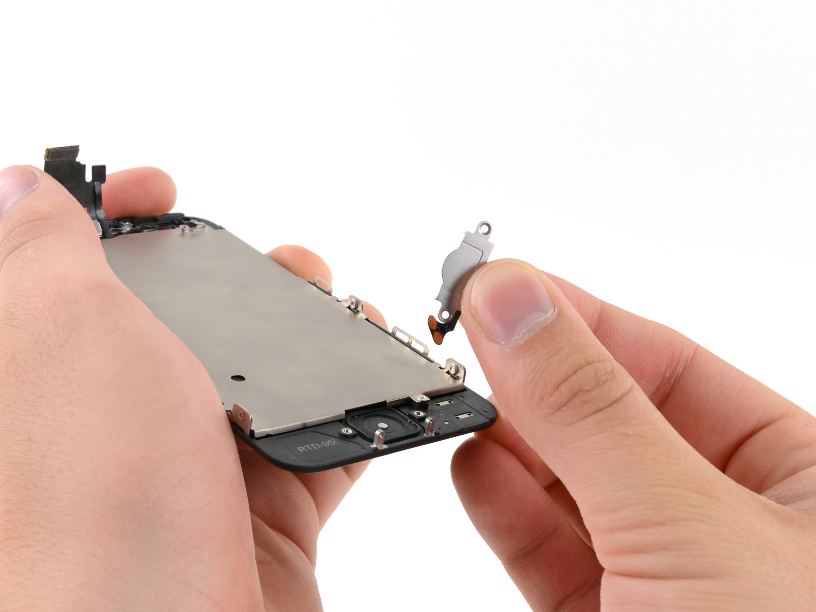

Remove the two 1.3 mm Phillips #000 screws securing the home button bracket to the display assembly.
NOTE: When reinstalling the two 1.3 mm Phillips #000 screws, take care not to over tighten them as they can penetrate the other side of the display.
