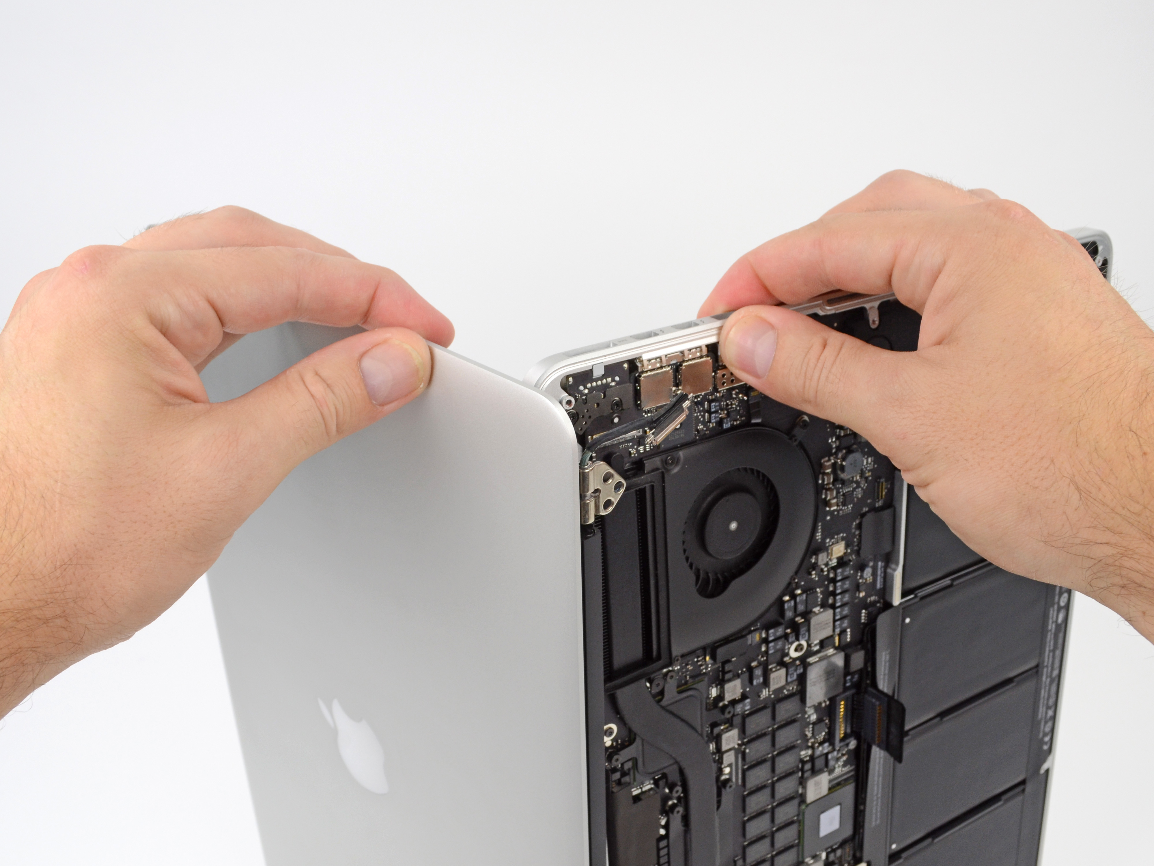

  15. MacBook Pro 15" Retina Display Mid 2012 Display Assembly Replacement: step 15, image 1 of 3 MacBook Pro 15" Retina Display Mid 2012 Display Assembly Replacement: step 15, image 2 of 3 MacBook Pro 15" Retina Display Mid 2012 Display Assembly Replacement: step 15, image 3 of 3
    • Grip both halves of the device, one in each hand.
    • Gently push forward on the bottom half of the device to detach it from the display assembly.
    • Carefully set each component aside, making sure to set down the lower half keyboard-side down.
