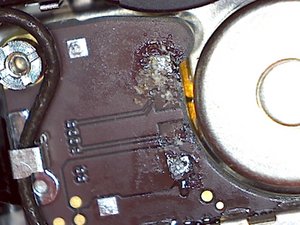

How do I fix the broken prong on my battery connector?
So I noticed when I put my phone back together that everything worked fine, but the battery wouldn't charge.
After taking it apart and inspecting it, I noticed that where the battery pins make contact with the logic board have been damaged.
Specifically, where the four battery prongs are lightly soldered to the board, when I removed the battery, the solder connecting the pin to the board was so strong that instead of detaching from the little square on the board, it pulled the square up with it.
Short of buying a new logic board and battery, is there any way to re-connect this somehow? I can provide pictures if needed. Thank you for your help.
Edit: Here is a picture.
http://imageshack.us/photo/my-images/854...

Pictures would help.. One of our regular contributors repairs these and may be able to give an expert opinion on where to go form here depending on which pad is missing

Okay updated with picture. Hopefully that should help. The problem is that apple lightly soldered the battery pins in place, so when i removed the battery, it ripped one of the square connecting pads up. since it looks like the square pads lead to the circular ports to their left, I'm guessing I should be able to wire it back somehow with some fine gauge wire, but I'm not really sure how, and I've never done soldering this small.

What you can do is solder to the CIRCLE right behind that missing solder pad. If you can get a connection there, then the phone will work again. Along with that, you have to solder to the other existing pads as well. This repair is tricky and takes a bit of patience to do. In the event that the circle pad isn't secure, I usually run a jumper wire to the main connection point under the heat shield.

So instead of solder (since I'm unsure I can solder with that kind of precision), I got a $20 pen from radioshack that emits conductive silver designed for making quick repairs to circuits by drawing on new paths...i was thinking of drawing a conductive path from where the square will touch the board to the circle to the left of the square. Does this sound like a bad idea from your experience?
Also, you said, "along with that, you have to solder to the other existing pads as well". Could you clarify that please? Specifically, what should I solder what to the other pads?

Update: Just tried soldering from where the pad was before to the circle and I can get the phone to boot plugged in but not unplugged. the battery says it's charging when it's plugged in but the battery is not actually charging.

The other 3 pins need to be soldered to the board as well as the pin with the lift solder pad. What youre observing is an incomplete circuit, thus the phone dies when it is unplugged. I dont have experience with that pen youre talking about, but if you can get a small iron (small sized tip) you can probably manage it.

Ah, okay so you were right, I tried soldering the connections back, but the phone acted as a heat sink and I couldn't get enough wattage with such a small solder tip. The pads were strange. I think I'm going to have to solder jumper wires in. Can you please tell me more details about how you'd advise I do that? What kind of wire to use and how? I can see your picture...are the top and bottom pins of the battery connector wired to anything? or do I just need to worry about running jumpers to the middle two pins and then all the way to where you have them wired?

We see dozens of these battery connector failures in our store every week. It is a very common repair for us. Here is how we have approached this repair. In coming up with this, we have spoken to (3) of the top circuit board rework companies in the US to solicit their input as to the strengths and weaknesses of each repair option.
In many cases when the battery terminal connector is ripped from the motherboard, one or more of the solder pads is removed as well. This is bad. The purpose of those solder pads is to act as a base for creating a solder fillet (joint) between the legs of the terminal connector and the motherboard. Each of those pads has a copper tailing that comes out and connects to the trace on the motherboard. When the pad is ripped out, you also lose that copper tailing connection to the trace.
In our shop, we use the following standard procedure (again that was developed in conjunction with several motherboard rework companies).
1. We clean up the solder off of any remaining pads using a solder wick.
2. We then install new solder pads to replace the missing ones.
3. We use an exacto knife (or razor blade) and CAREFULLY remove the very top layers of the motherboard trace down to the point where the copper wire is exposed. You need to be careful as you only need to expose roughly the last 1/2" where the trace connects into the pad.
4. We then overlay solder the copper tailing off the new solder pad onto the exposed copper trace.
5. Once that is completed, we go in and put an epoxy coating on top of the exposed trace.
6. We use the same process for any other missing pads.
7. Lastly, we reinstall a new battery terminal connector by soldering it back onto the (4) solder pads on the motherboard. We also use a dab of neutral core silicone under the connector to better adhere it to the motherboard.
It is a very tedious process and one that is not simple, but it is the correct way to repair this iPhone 4S with a broken battery connector and lifted solder pad.

http://imageshack.us/photo/my-images/52/... take a look at this pinout.. Looks like it's a ground so try solder the coneector you may get away with no pad!
