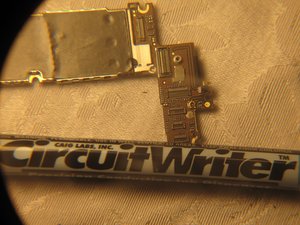

After replacing screen camera app now stuck on shutter?
Hi,
I replaced a smashed screen for a customer, and after I put it back together, the camera app is now stuck on the shutter. Could I have damaged the front or rear camera or connectors? I have checked the connections many times, but no luck. I've also rebooted the phone, etc.

The problem is a tiny jumper that gets damaged or falls off during disassembly. It's just above the 3rd-from-the-right ribbon connector to the logic board on the iPhone 4. If it's missing, the front camera won't initialize and will lock the shutter for both cameras. I found the answer and a picture of it on gsmindia.com. I used a circuit writer pen from Radio Shack to jump it, and all was well again.

Hey don, I bought the circuit writer and did exactly as you said. The pen says to allow it to dry after 24 hours. Is that only when it will work, once it dries?
by
Noticed I never posted an update to my comment. 4 years later lol. it worked great once dry. Great fix
by

Hey Don L, do you think you can specify on how you used the circuit pen? i have the same problem and am about to purchase the pen i just want to make sure i know what im doing

Thank you for posting this!
That component was missing on my logic board. It probobly got knocked off when I did an lcd change. Since then, the camera shutter would freeze, and I could only use the camera from within a texting app, but it would freeze again if I tried to switch to the front camera.
I made the jumper with a circuit-writer pen, and both cameras are working like normal again.

HI, i did the jumper with the circuit writer pen, and my front camera is working great, thanks

This is the part that is damaged have used a circuit writer on this before and has worked this componant becomes loose or lost completely also you can use solder to bridge the gap

I have installed a new rear camera in my iPhone 4, to replace the one that gets hot and drains the battery. The new one doesn't work, I fit back the old one and it works I fit a second new one it doesnt .. The old one does again, but this still gets hot again.... Have I got something else to do,

I have had it too. It must be the screens actually I had two out of four. I tried everything I could including putting the screen on a phone that worked. No fix for front camera but I can tell you how to unlock it.
Go to setting/general/reset (scroll to bottom)/reset all settings.
It will ask for confirmation.
After I did this the back camera will worked, but if I try the front it locks up, this affects facetime as well.
Note this only changes settings like background, ringtones, etc. does not effect data and pretty quick to do.

I had this problem, I do repairs myself, i couldn't fix, took it to 2 other repair shops they couldn't fix it either, when I got it back the final time I took it apart again, blew it out and reseated it and suddenly it just started working again and has been fine ever since. My jumper was not missing so everyone was clueless... seemed like a fluke, don't know what caused it, and not sure how many times it was taken out and put back in but I'd guess at least 6/7 times, if your jumper isn't missing I'd just keep trying! It's a horribly frustrating problem if you're not missing the jumper and know your cameras are good

The camera needs to have the lens shield replaced from the prior screen or it will not work. The lens shield pushes the camera tight against the back steel retainer making contact with it and then the retainer makes contact with the bottom side of the board for grounding purposes. The fix without the camera lens shield is to wedge a small piece of metal between forcing/making contact with the metal retainer.

without the camera shield would the (rear) camera just be greyed out and front fine
