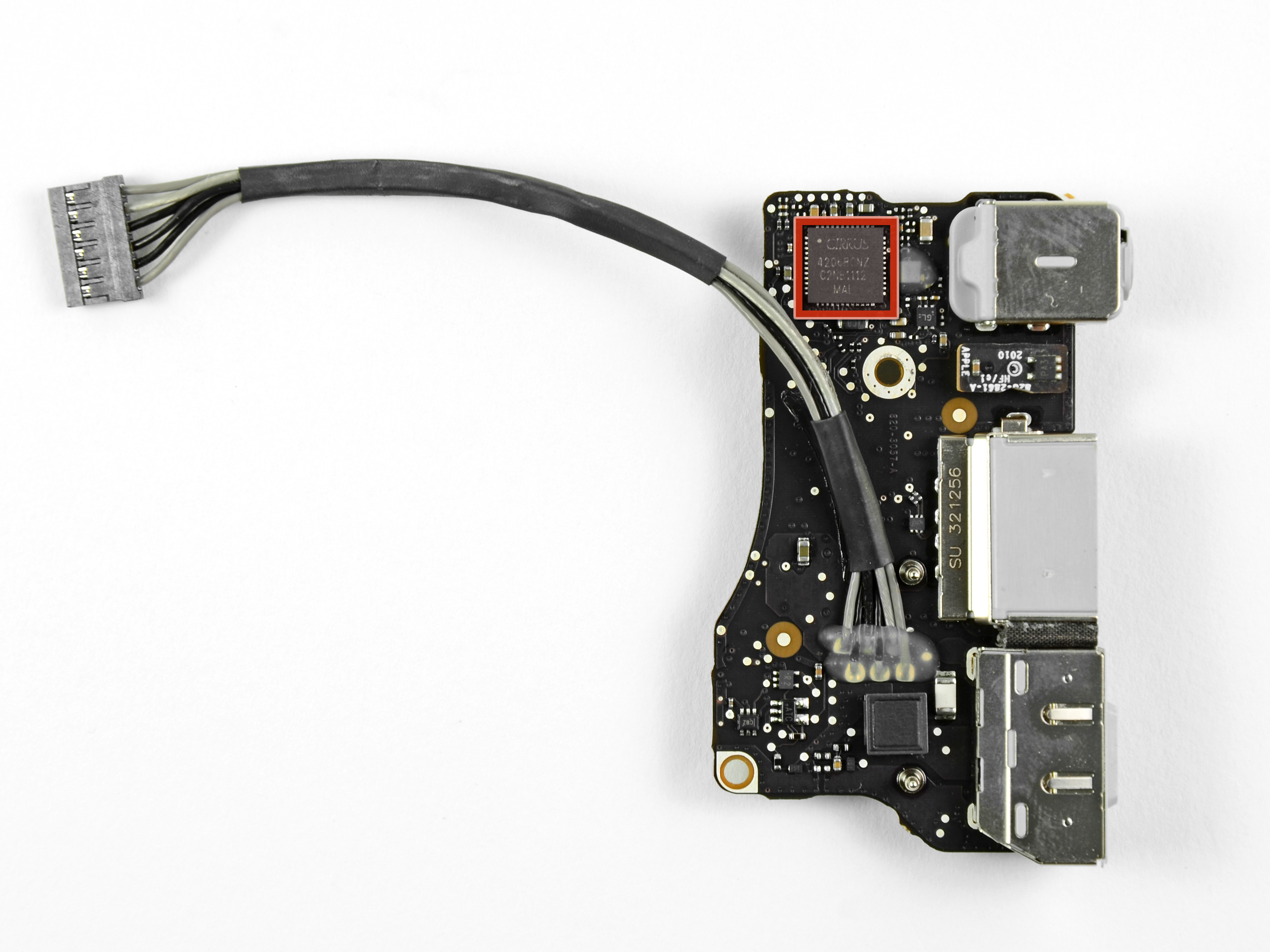

I have a late 2010 MacBook Air that has suddenly started sleeping every few seconds. I suspect a problem with the Hall Effect sensor falsely indicating the lid is closed. I could not find much information on the location. With some experimentation, it appears this is on the left side of the laptop, where the I/O board is located. Is the Hall Effect sensor part of the I/O board? In other words, is replacing the I/O board a likely solution?

Remove the I/O board, you'll see a small sensor on a stack of thickened PCB

Thanks. To clarify: The short answer is, "yes." I found the sensor attached to the top-facing side of the I/O board, on a riser as Tom described. I was able to verify that powering-up the laptop with the I/O board removed did eliminate the sleep problem--but, of course, introduced an array of new problems. Unfortunately, cleaning and reattaching everything did not resolve the issue which returned with the I/O board reinstalled, But, I'm anticipating that a replacement will resolve the issue.

My replacement I/O board arrived yesterday, and did indeed resolve this problem. Thanks again.

Here's the IFIXIT guide to replace the I/O board: MacBook Air 13" Late 2010 I/O Board Replacement. Often I find I need to replace the I/O cable as that sometimes gets damaged. As to a picture of the other side not much to see here: I/O logic bod from Mid 2011 model which is almost identical The Hall sensor is the square block just under the cable harness. I would try using a magnet placing it near the left side Tab key to see if it goes into sleep mode.
