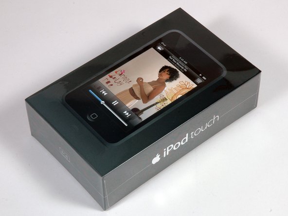

Behold, the iPod Touch.
  • Behold, the iPod Touch.

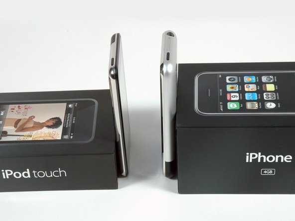

Side by side with the iPhone, you can see how similar the devices are.
  • Side by side with the iPhone, you can see how similar the devices are.
  • At 8 mm thick and 4.2 ounces, the iPod Touch is smaller and lighter than the iPhone (11.6 mm and 4.8 ounces).
