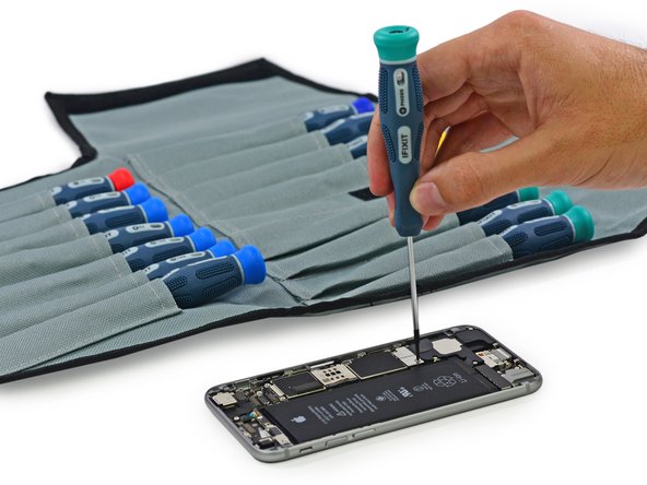

Image 1/2: With screwdriver in hand, we tackle the metal bracket screws that secure the front panel assembly in place. Image 2/2: With screwdriver in hand, we tackle the metal bracket screws that secure the front panel assembly in place.
  • While there may not be any Phillips screws on the outside of this phone, there are certainly Phillips screws on the inside. Fortunately, our Pro Tech Screwdriver Set can handle any type of screw this phone dishes out.
  • With screwdriver in hand, we tackle the metal bracket screws that secure the front panel assembly in place.

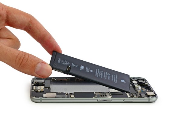

Image 1/2: This adhesive is similar to a 3M Command adhesive, and when you pull the tab correctly it shears the entire strip off. Image 2/2: This adhesive is similar to a 3M Command adhesive, and when you pull the tab correctly it shears the entire strip off.
  • We love these battery pull tabs. Pulled correctly, they'll save you the hassle (and potential hazard) of coaxing the battery out with a pry tool.
  • This adhesive is similar to a 3M Command adhesive, and when you pull the tab correctly it shears the entire strip off.
Image 1/2: Apple preaches that this 28-gram (3.75" x 1.5" x 0.13") power pack will let you talk for up to 14 hours on 3G and offers 250 hours of standby time. Image 2/2: This is a fair bit smaller than the iPhone 6 Plus's 11.1 Wh, 2915 mAh battery—but still a notable bump from the 1560 mAh unit in the iPhone 5s.
  • The iPhone 6 features an 1810 mAh, 3.82 V Lithium-ion Polymer battery with an energy rating of 6.91 Wh. Turning it over, the rating improves to 7.01 Wh! Perhaps the engineers were able to squeeze an extra 0.1 Wh in the battery after confirming the text on the front.
  • Apple preaches that this 28-gram (3.75" x 1.5" x 0.13") power pack will let you talk for up to 14 hours on 3G and offers 250 hours of standby time.
  • This is a fair bit smaller than the iPhone 6 Plus's 11.1 Wh, 2915 mAh battery—but still a notable bump from the 1560 mAh unit in the iPhone 5s.
  • This battery seems to have an identity crisis. On the front are markings of Apple South Asia (Thailand) Limited and Apple Japan. On the back, it says it's actually made in Huizhou, China.
How does the 28-gram weight compare with previous versions ? And to the iP6 Plus density ?
64.6 mA per gram is better than competing battery solutions from LG and Samsung ?
Joao Fabio Tavares - Reply
Probably the 6.91 Wh is the design capacity and the 7.01 Wh is a measured value
cabo - Reply
I don't see an identity crisis for this battery, the Thailand and Japan text are next to mandatory regulatory marks for batteries in those countries (circled diamond logo and circled PSE logo). Between them is a UL recognised component mark (c reversed UR US mark). Presumable it is less trouble for Apple to apply for them through local subsidiaries.
Bryn Jones - Reply

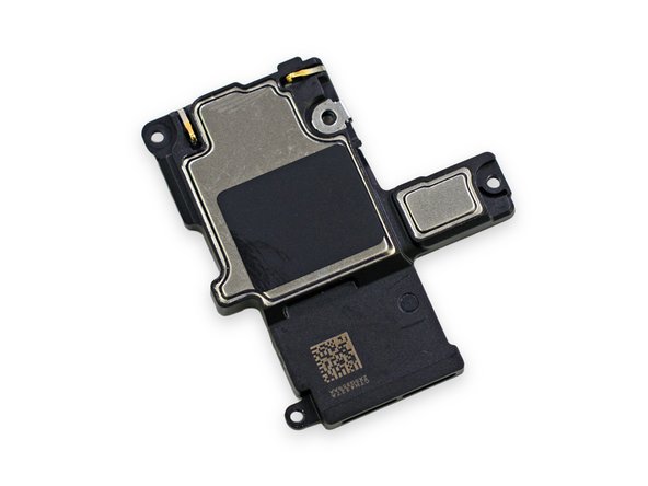

Image 1/2: Vibrator mechanisms seem to be one of those choices like Coke or Pepsi where there is never a clear answer. Apple keeps changing this part's design: Image 2/2: [link|https://d3nevzfk7ii3be.cloudfront.net/igi/NMSB5GPK3UIGJT2A|iPhone 4|new_window=true] (counterweight)
  • Removing the vibrator assembly. It's new and... improved?
  • Vibrator mechanisms seem to be one of those choices like Coke or Pepsi where there is never a clear answer. Apple keeps changing this part's design:
  • Based on appearances, we're guessing that Apple went with a linear oscillating design in this rendition of the iPhone.
