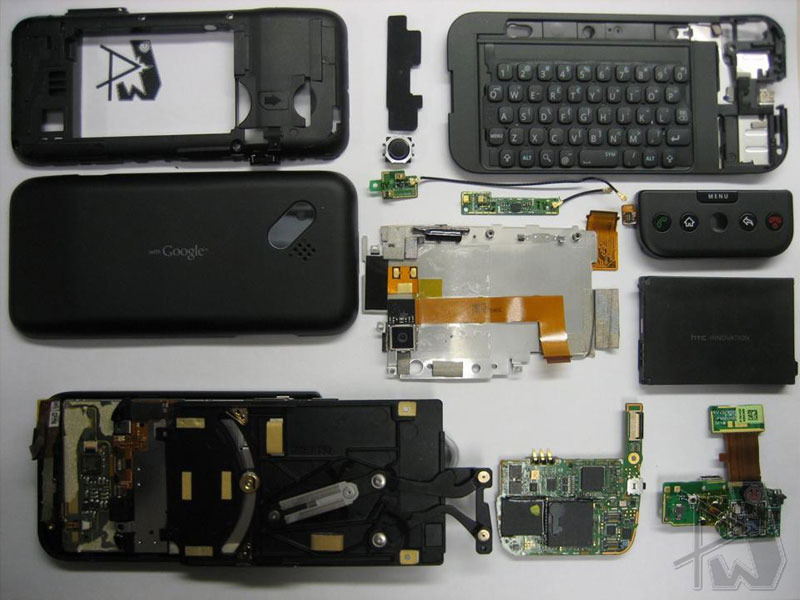

    • The T-Mobile G1 was a mind-blowing experience to crack open. There’s an insane number of parts, and the way they put it together seems, well, complex. Make sure you give the sliding mechanisms a peek near the bottom.
    • Finally, the moment you’ve all been waiting for. The back of the casing, showcases swooping action (we’re seriously too in love).
    • The translational springs on this puppy are strong as !&&*. But it needs to be so, since it has to drive a large screen around an arc. It’s interesting to note how much effort HTC seems to have put in to produce a clean swooping action. Perhaps we’re overthinking this.

    • This part is pretty cool, because housed within the screen casing is four large parts.
    • On the front of the actual casing is the capacitive touch panels, with Synaptics handling the controllers and everything else touchscreen-related.
    • An interesting feature of this phone are the dual vibration motors. One motor is mounted on the display module, and the other on the main PCB.
    • There are two main PCBs housing most of the components. The main PCB is shown at left, while the “Chin” PCB is shown on step 9.
    • The NAND Flash + DDR SDRAM is handled by a Samsung MCP.
    • SMSC provides the USB PHY handling the connection from the processor to the PC.
    • As shown, Avago provides both GSM and UMTS power amplifiers (ACPM-7381 & ACPM-7391).
    • TriQuint provides their regular GSM power amplifiers (TQS 7M5008).
    • Asahi Kasei makes an interesting appearance with the first (to our knowledge) appearance of a compass IC.
    • Lastly, we move on to the "chin" PCB.
    • Texas Instruments provides the Bluetooth and Wi-Fi chips, both appearing on this PCB.
    • The trackball is the same module used on nearly every BlackBerry (except the upgraded trackball found on the Javelin).

A note to HTC G1 owners. If you're trying to take the device apart, pay close attention and make sure that you pry the key pad on the front below the screen up before you attempt to remove the screen. Improper placement of the LCD flex cables can result in damage to them, rendering your device useless until you replace the LCD flex cables.
