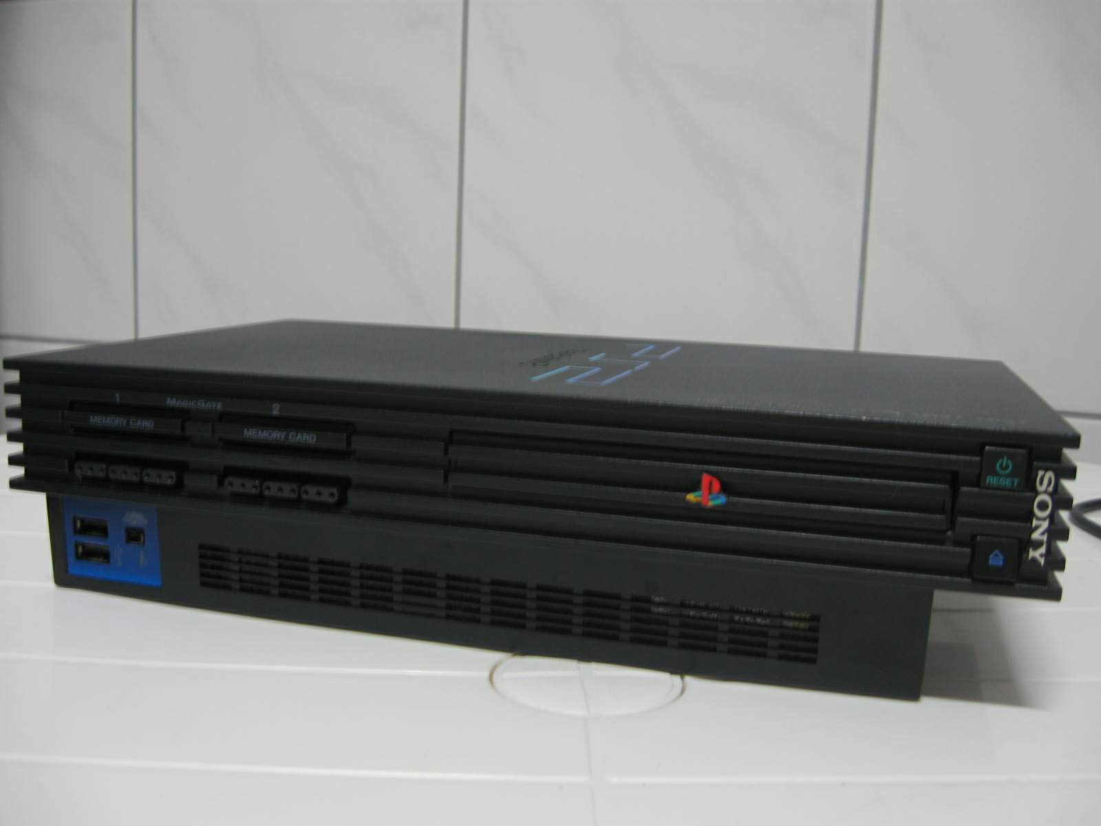

  1. PlayStation 2 Teardown, PlayStation 2 Teardown: step 1, image 1 of 3 PlayStation 2 Teardown, PlayStation 2 Teardown: step 1, image 2 of 3 PlayStation 2 Teardown, PlayStation 2 Teardown: step 1, image 3 of 3
    • Here we have the system console fully assembled.
    • The USB Ports.
    • The S400 ports
    • The Optical Drive
    • The reset button
    • The eject button

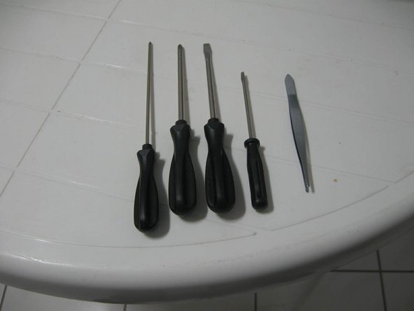

    • These are the only tools that we will need. 4 screwdrivers and a tweezer.

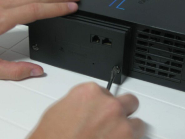

    • Lets start the teardown. At first we use a Flathead screwdriver to remove the ethernet adapter.
    • Remove these 2 screws with a Flathead screwdriver.
    • And is quite simple to pull.

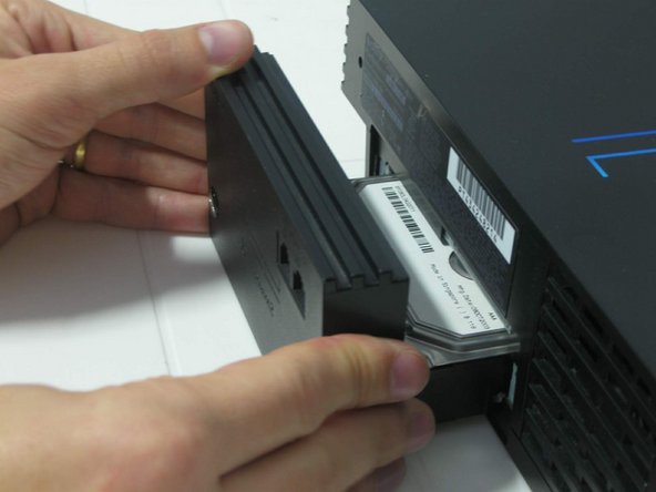

    • This is the expansion bay, where the hard drive goes.

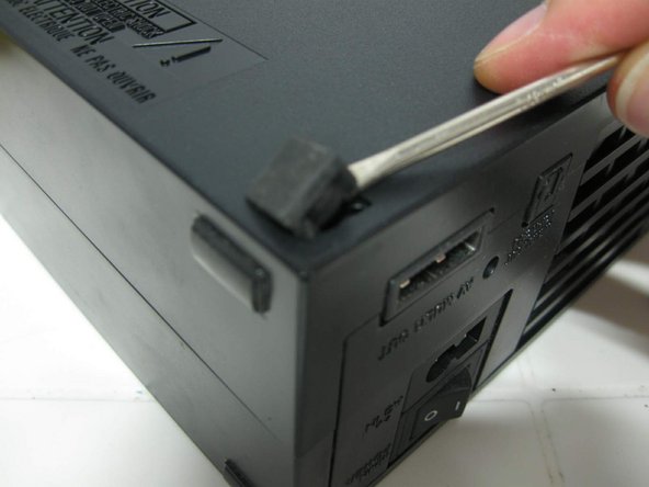

    • Turn the console upside down.

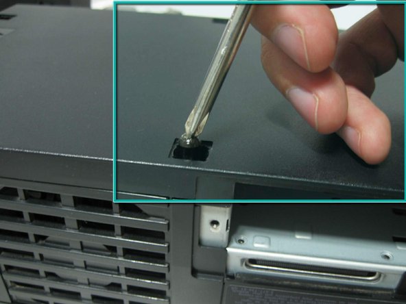

    • Using a small Flathead screwdriver, remove the screw protections. In this model, we have 8 of them.

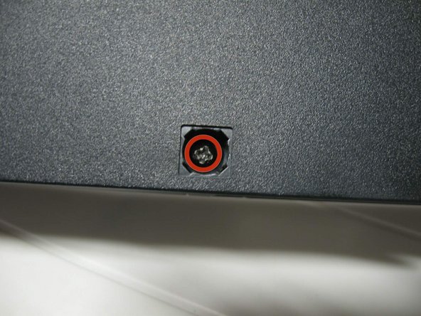

    • Under the protection, suprise! a screw!
    • Remove all eight (8) screws with your Philips "0" screwdriver.
