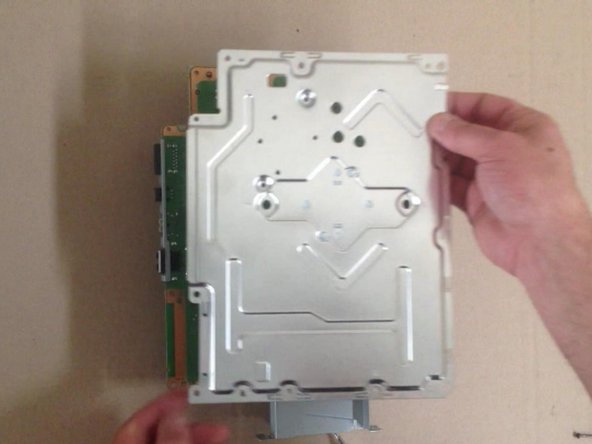

    • Remove the seven Phillips #1 screws indicated.
    • Lift the motherboard assembly up out of the lower half of the case to remove it.
    • Carefully disconnect the Wi-Fi antenna cables and fan connector indicated by red arrows.
  9. PlayStation 3 Super Slim Teardown - Video tutorial: step 9, image 1 of 3 PlayStation 3 Super Slim Teardown - Video tutorial: step 9, image 2 of 3 PlayStation 3 Super Slim Teardown - Video tutorial: step 9, image 3 of 3
    • Remove the six Phillip #1 screws indicated to separate the heatsink and shield from the motherboard.

i took apart my ps3 super slim and put it back together but there is no power what so ever no red light at all
pastorjon.m - Reply
Same here did you fix it?
Kriss -
One thing to pay attention to: The T8 Torx screws (at least on my 500GB model) are Tamper Proof TR8 screws, meaning you need a special screwdriver to undo them. A normal T8 wont work.
