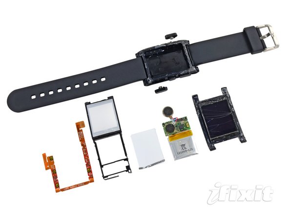

    • Now, we eviscerate the Pebble.
    • So much for the tech gore you've come to expect from our teardowns. There's not much here to eviscerate: the Pebble innards are housed in a single simple assembly, boxed within a light plastic frame.
  8. Pebble Teardown: step 8, image 1 of 3 Pebble Teardown: step 8, image 2 of 3 Pebble Teardown: step 8, image 3 of 3
    • Just a swish and a flick of the spudger and the lone ribbon cable surrounding the whole assembly is freed.
    • The cable's adhesive also secures the backlight guide, allowing the LEDs to shine on, providing backlighting for the e-paper screen.

    • Removing the ribbon cable from the main assembly gives us a closer look at the buttons and Bluetooth antenna on one side, and the backlight LEDs on the reverse.
    • Since the cable houses all 4 buttons, 3 LEDs, and the Bluetooth 2.1 antenna, replacing an individual component will be impossible (even if you can somehow get inside without compromising the display).
  10. Pebble Teardown: step 10, image 1 of 3 Pebble Teardown: step 10, image 2 of 3 Pebble Teardown: step 10, image 3 of 3
    • Removing the backlight guide panel from the device grants us access to the motherboard/battery/vibrator assembly.
    • Much like the ribbon cable, three components make up this assembly, held together by very delicate soldering. If any one of them fails (most significantly the battery), they will all need to be replaced as a single unit.

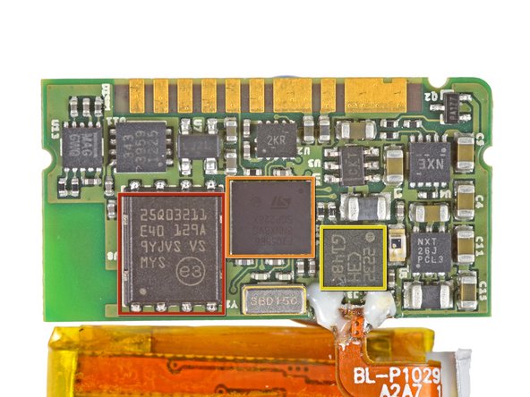

    • The ICs of interest on the top side of the motherboard are as follows:
    • Micron N25Q032A11ESE40F 32 Mb serial flash
    • STMicroelectronics STM32F205RE high-performance ARM Cortex-M3 MCU, with a maximum speed of 120 MHz
    • STMicroelectronics LIS3DH 3-axis accelerometer
    • Oscillator
    • Texas Instruments BQ24040 1A Battery Charger
    • Xtrinsic MAG3110 3D Digital Magnetometer

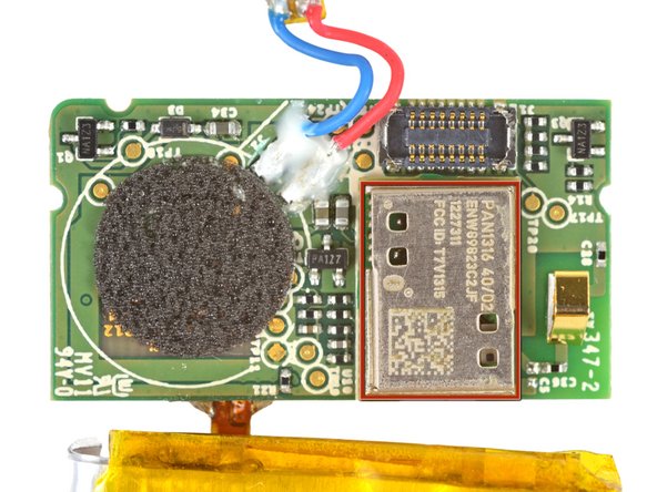

    • The back of the motherboard hosts a Panasonic pan1316 RF module, promising the Pebble's advertised Bluetooth and Bluetooth Low Energy (BLE) functionality, powered by a Texas Instruments CC2564 Bluetooth Controller.
    • After some dainty desoldering, the module's EMI shield is removed to surprisingly reveal a slightly different Texas Instruments CC2560A, that appears to not include BLE support.
    • The Bluetooth antenna printed into the flex circuit board connects to the pan1316 BT module here.
    • Word on the street was that Pebble had BLE functionality just waiting to be activated with a firmware update, but we can't find evidence of the hardware to back up this hidden potential.
    • Update: Pebble assures us that the update will be forthcoming, and explained that TI uses the same silicon for both the CC2560 and CC2564 parts—so despite the label on the chip, the update will make this a CC2564 with BLE support.
