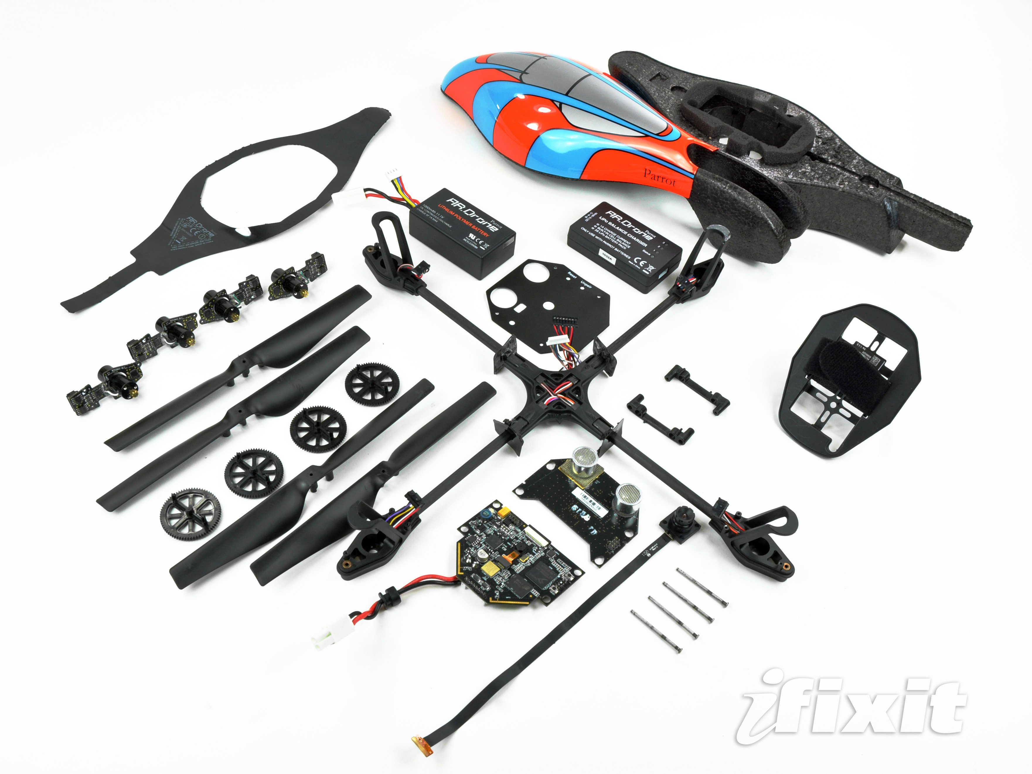

    • The Parrot AR.Drone remote-controlled quadricopter recently landed on our teardown table.
    • What's cooler than one quadricopter? Two quadricopters, of course! The AR.Drone comes with two hulls: an indoor unit with guards over the propellers (grey/white) and an outdoor unit (orange/blue).

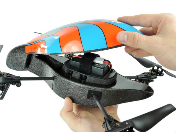

    • Talk about repair-friendly; opening up the AR.Drone doesn't even require a screwdriver. (Compare this with some recent devices we have torn down!)
    • The hull is attached to the body by a pair of magnets; one in the hull and one on the body.

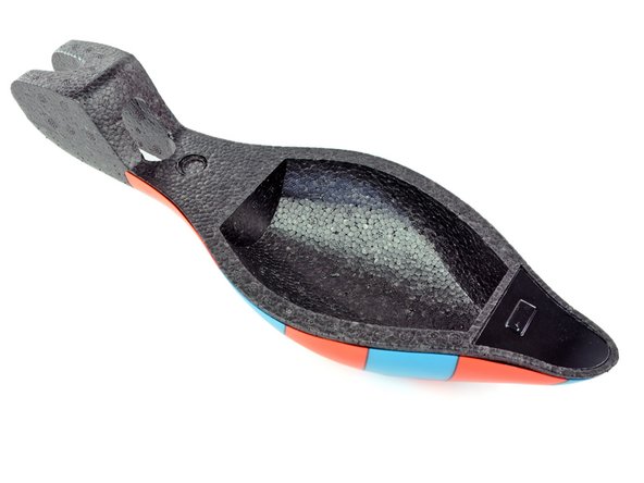

    • Much of the AR.Drone's body is made of expanded polypropylene (EPP), a common substance that is both extremely light and easily manufactured into complex shapes.

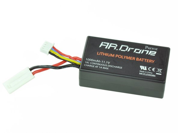

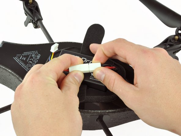

    • The 1000mAh 11.1V lithium polymer battery is attached via a connector, making it delightfully easy to remove.
    • The second connector is a balance charge connector, which ensures that each of the three battery cells is charging equally, thus optimizing capacity and prolonging battery life.
    • The battery contains a protection circuit module, which prevents it from discharging too rapidly, over charging, or short circuiting.
    • Parrot claims the battery will only last about 12 minutes after a full charge, which takes around 90 minutes. Taking your AR.Drone out to the park with only one battery won't get you much play time, unfortunately.

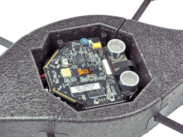

    • Next, we turn to the underside of the quadricopter.
    • After removing four T6 Torx screws, the lower plate can be lifted off to reveal the motherboard and navigation board.
    • The navigation board is connected to the motherboard by eight pins and comes out without any hassle.

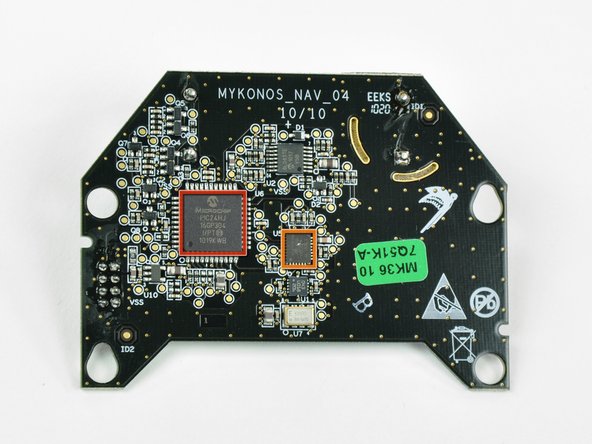

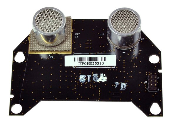

    • The two large mesh cylinders make up the ultrasound altimeter, which stabilizes the quadricopter within 6 meters of the ground.
    • The back side of the navigation board contains the Microchip PIC24HJ16GP304 40MHZ 16-bit microprocessor.
    • The MEMS gyroscope, the Invensense IDG 500, is also found on this board.

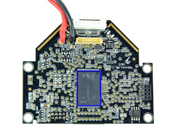

    • Front of motherboard:
    • Parrot 6 ARM9 468 MHz processor.
    • ROCm Atheros AR6102G-BM2D b/g Wi-Fi module.
    • Micron OGA17 D9HSJ
    • Vertical camera.
    • USB/serial port connector
    • On the back:
    • Micron 29F1G08AAC

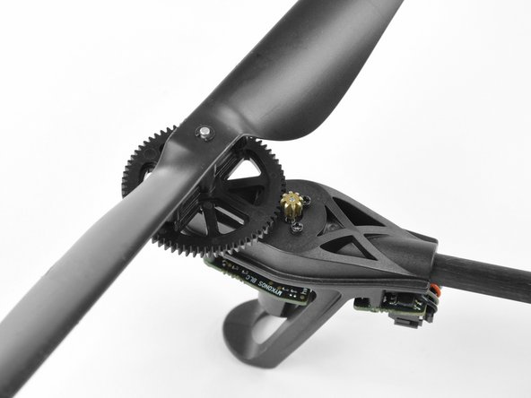

    • Each propeller assembly is made up of the propeller blade, gear, motor and motor controller board.
    • These are not your run-of-the-mill propellers. The design team behind these won a micro drone design contest put on by the French Army.
    • The propellers spin in different directions depending on the side they are mounted on, and are marked either C (clockwise) or A (anti-clockwise).

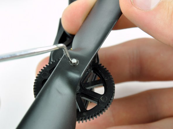

    • The propeller blade and gear are held in place by a small circlip on a stainless steel shaft.
    • Parrot sells a special circlip removal tool, but we opted for a pick we had lying around the office.
    • These little guys can definitely go flying if you're not careful. Luckily, they come as part of two different replacement parts packages available directly from Parrot.

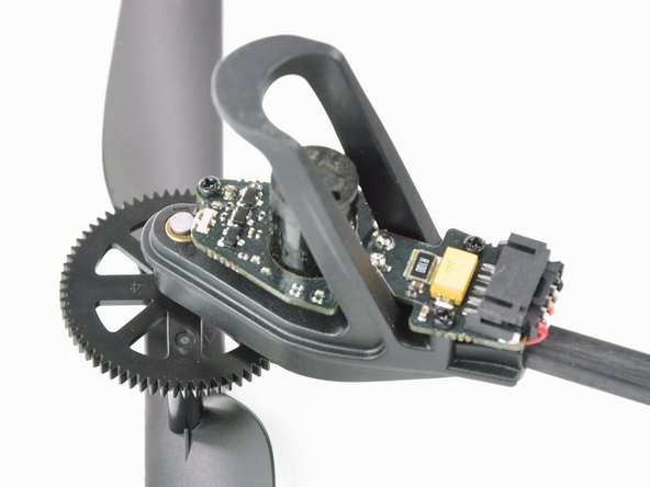

    • The four motors and their electronic controllers are each held to the central cross by six screws and a connector.
    • Each brushless motor runs at 28,000 RPM while the AR.Drone is hovering, and as fast as 41,400 during full acceleration.
    • The speed of the motor is managed by the electronic controller, which includes an 8-bit microcontroller and a 10-bit ADC.

    • Parrot AR.Drone Repairability: 9 out of 10 (10 is easiest to repair).
    • The battery and upper case come off easily without removing a single screw.
    • Almost everything is attached via ribbon cable connectors and screws, making replacement much more feasible.
    • Parrot provides replacement parts and repair videos for common problems. Repair wouldn't be very easy without both of these.
    • The c-clips on each propeller assembly are very hard to remove without the correct tool.
    • It's a pain to reapply adhesive after removing all the adhered parts.
