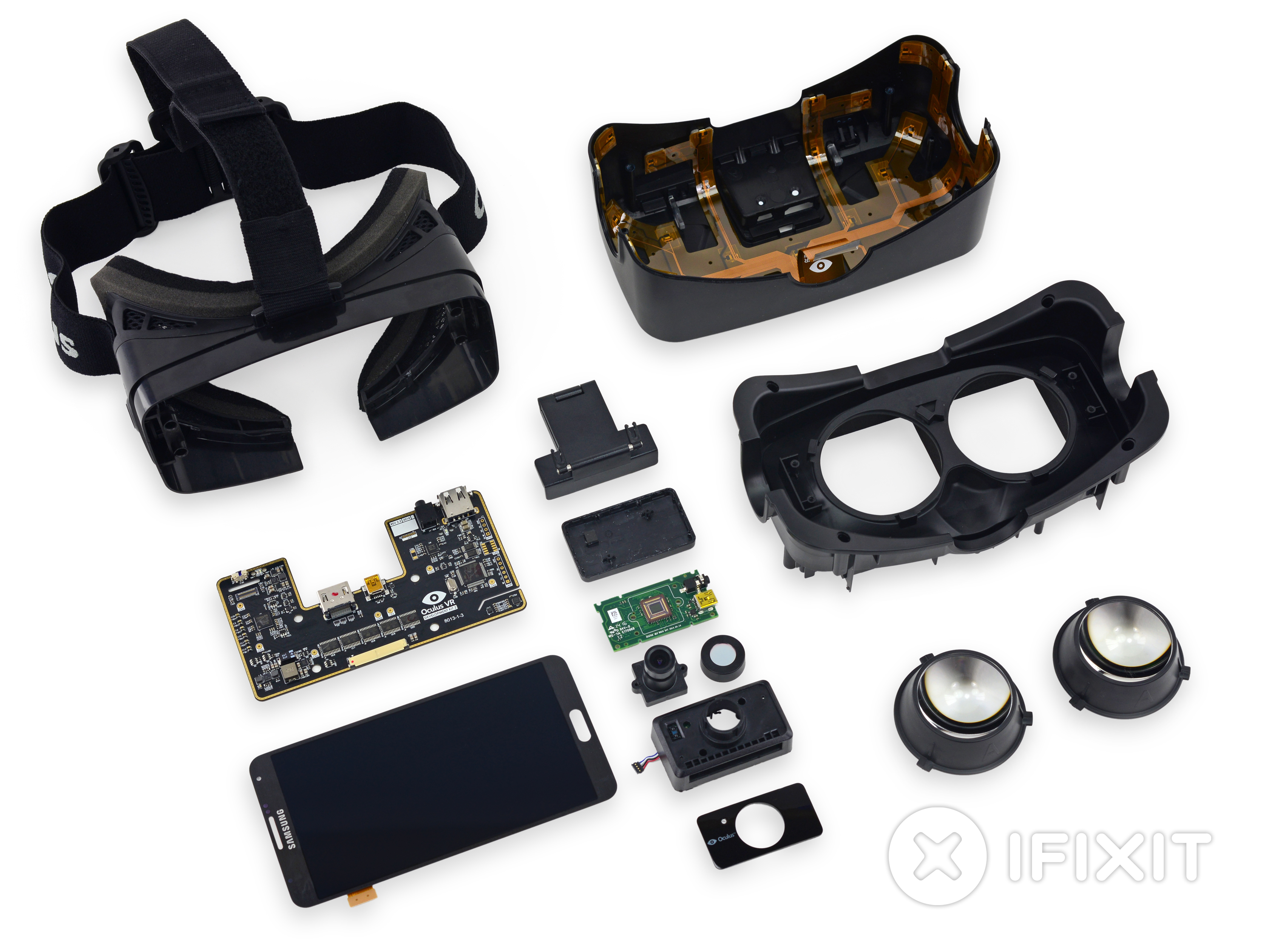

Oculus VR took the world by surprise last year with the Oculus Rift. This year, they seek to push their own self-created envelope with the Oculus Rift Development Kit 2. We may not have flying cars, hoverboards or (commercial) teleporters, but we do have the latest virtual reality tech. Join us as we ogle the wizardry in the Oculus Rift DK2, teardown style.
Don't fight the future—watch it unfold one teardown at a time on our Facebook, Instagram, or Twitter.
Image #1
Edit Step 1 Oculus Rift Development Kit 2 Teardown  ¶
  • The folks at Oculus VR have had a busy year. Their hard work culminates in an amazing bit of technology, the Oculus Rift Development Kit 2. Features include:

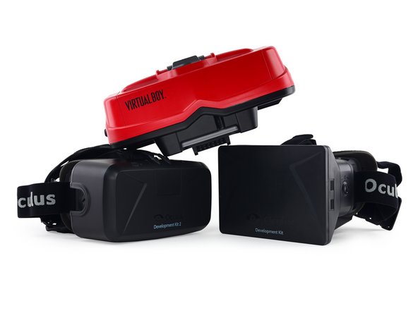

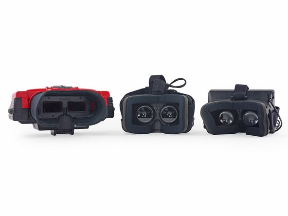

  • We have an ocular face off! Development kits 1 and 2 have a staring contest, giving us time for a quick comparison.
  • The first thing we notice is that DK2 shows some noticeable streamlining in size and shape.
  • Without warning, the forefather of VR headsets crashes the party—the Virtual Boy.
  • It's a fight to the virtual death! The contenders weigh in at:
    • 896 g for the Virtual Boy, making it the heavyweight champ (although, to be fair, this was never supposed to hang off of your face)
    • 453 g for the newcomer to the ring, the DK2
    • 395 g for last year's lightweight fighter, the original Rift

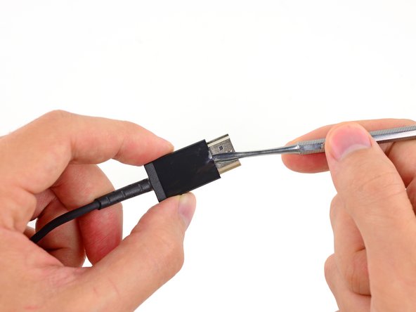

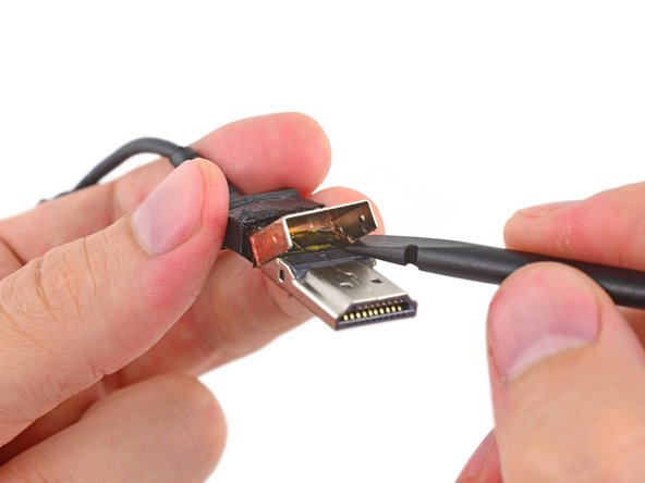

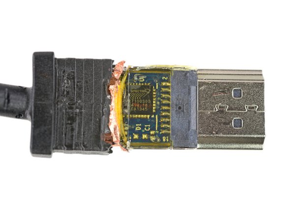

  • Keeping up with the Oculus news recently, we figured there might be something lurking within the HDMI cable, just like with Apple's Thunderbolt cable from awhile back.
  • With a couple flicks of our metal spudger, we find we were right—a hidden IC presents itself!
  • We find the Spectra7 VR7100 processor buried under what seems to be a thick encasing of glue.
    • According to their product brief, the little doohickey "reduces size and weight of HDMI copper interconnects..." and "supports video formats up to 4K 60p" — hot stuff!
    • Well now we know why the cables got so much thinner when compared to the DK1.

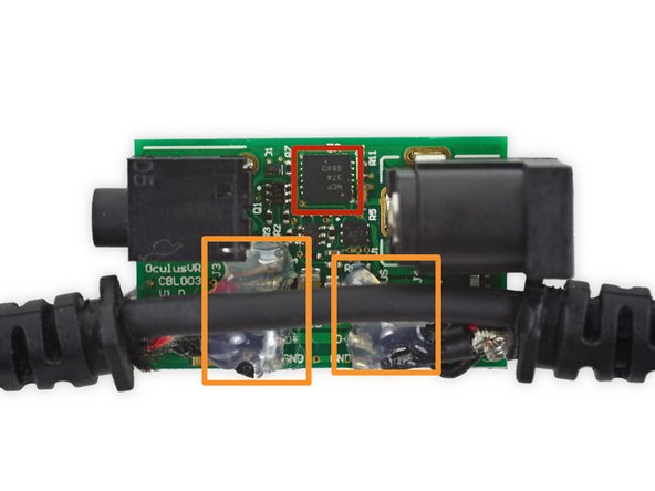

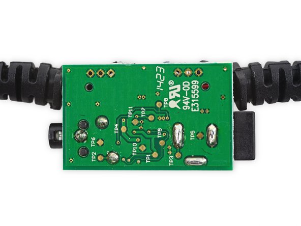

Edit Step 11  ¶
  • Let's pop open the slick new cable hub and find out what's inside:
    • ON Semiconductor NCP 374 overvoltage protection device with load switch function
    • You can sleep soundly knowing that those cables aren't going anywhere, because Oculus didn't skimp on the globs of hot glue on the inside of the cable hub.

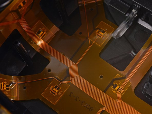

  • Opening the treasure chest a bit further, we get a glimpse of a whole entire motherboard, not the tiny boards of yore.
  • But what's all this orange cabling? Looks like we found the many sources of those many, many IR LEDs.
  • There are eleventy nine forty of them, artfully connected via a ribbon cable designed by space elves.
    • We can neither confirm nor deny the existence of space elves.

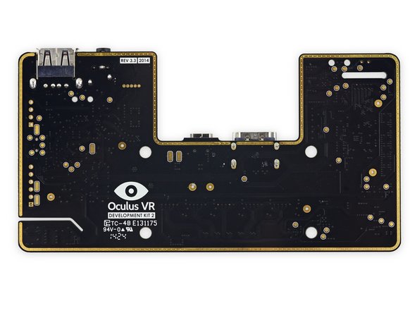

  • This motherboard is a major change from the previous incarnation of the Oculus Rift. All of the device's guts are now packed onto a single board, eliminating the need for an external control box.
    • We've got to hand it to Oculus, because they've really stepped up their motherboard design. It's easy to remove, and quite a looker as well. We'll have to see if this Oculus design can stand the test of time and make it into the consumer model.
Image #1
Edit Step 16  ¶
  • These are the ICs that make virtual reality a possibility:
    • Toshiba TC358779XBG HDMI Interface Bridge
    • STMicroelectronics STP16CPC26 Low Voltage 16-Bit Constant Current LED Sink Driver
    • STMicroelectronics STM32L100RB Ultra-low-power 32-bit Value Line ARM Cortex-M3 MCU with 128 Kbytes Flash, 32 MHz CPU, LCD, USB
    • Cypress Semiconductor CY7C65632 Very Low Power USB 2.0 Hub Controller
    • STMicroelectronics ST1S31 3A Step-down DC-DC
    • Invensense MPU-6500 Six-Axis (Gyro + Accelerometer) MEMS MotionTracking
    • Texas Instruments TPS65632A Triple Output AMOLED Display Power Supply

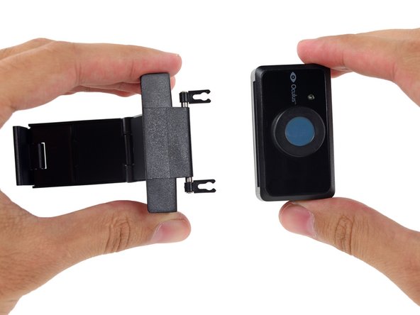

  • We may have exhausted the headset's goodies, but this teardown ain't over yet. We turn your attention now to the positional tracking camera.
  • The DK2 positional tracker's stand has several articulation joints and a tripod mount so you know it will always be there for you, bending over backward to help.
  • The positional camera itself is attached to its stand with two small clips. Once detached, we're free to crack it open to find the real goodies inside.

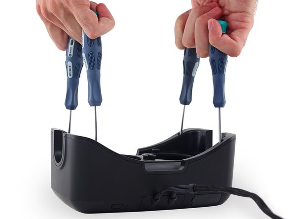

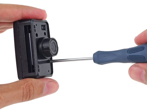

  • A sneaky cover plate hides a couple screws on the positional tracker's body, but our opening pick quickly sniffs them out.
  • The promising seams along the side are not for prying—ignore them. Ignore them well.

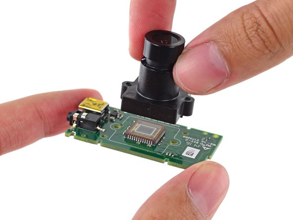

  • Once inside, the positional camera's motherboard and lens assembly are removed with ease.
  • We quickly dispense with two more screws, and then pop the lens assembly off the motherboard.
  • After playing around with the positional camera lens, we conclude that it's a wide angle lens. This allows the positional camera to see more IR LEDs at once, expanding its tracking abilities.
Image #1
Edit Step 23  ¶
  • Upon freeing this baby motherboard from its enclosure, we spy the positional camera's CMOS image sensor.

  • The Oculus Rift Development Kit 2 Repairability Score: 9 out of 10 (10 is best)
    • Given that the Rift is still a beta product, this is still a preliminary score—but things are looking good, and we hope the consumer version is just as repairable.
  • Standard Phillips #0 screws are used in both the headset and positional tracker, making it a cinch to open them.
  • Cable management is much improved from the original development kit, and the elimination of the control box makes for a simpler, more streamlined device.
  • The use of a common smartphone display means that replacement parts are readily available!
  • Getting into the positional tracker without a repair guide is a bit of a doozy. Prying around the edge won't help you here, but a thin tool in the front will.
