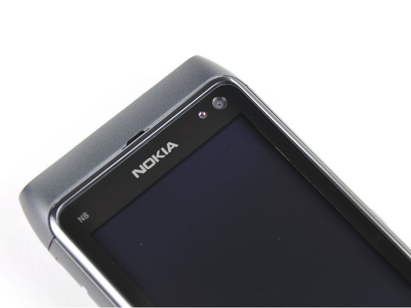

Edit Step 1 Nokia N8 Teardown  ¶
  • Our latest victim -- Nokia's just-released N8.
  • Technical specs:
    • ARM11 680 MHz processor
    • 640 × 360 (nHD), 3.5" capacitive, multi-touch display with AMOLED technology
    • 256 MB SDRAM
    • 512 MB internal NAND memory and 16 GB on-board memory
    • 12 Megapixels (main) with Carl Zeiss optics and Xenon flash, 16:9 720p video, 25 FPS

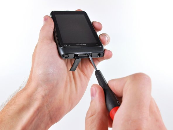

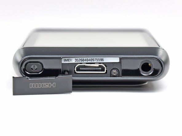

  • Aside from a standard 3.5mm stereo headphone jack, the N8 features both a mini HDMI and a micro USB port. Not sure what to do with that HDMI port? Try setting a world record.
  • Buttons include: Power, Home, Hold, Camera, and Volume Switch.
  • The SIM and MicroSD ports are mounted side by side on the exterior of the phone, allowing for hot-swapping of the MicroSD.

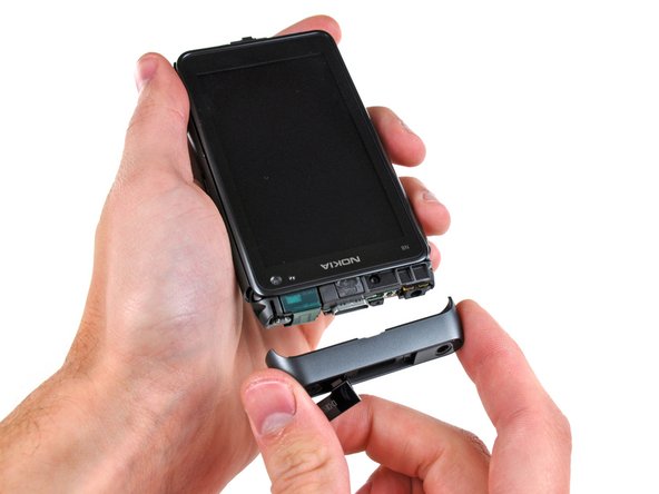

  • Hey look at that -- visible T4 Torx screws! We figured this was a good place to start to take it apart.
  • A trifle later the bottom portion of the phone was off. If we only had one of these...

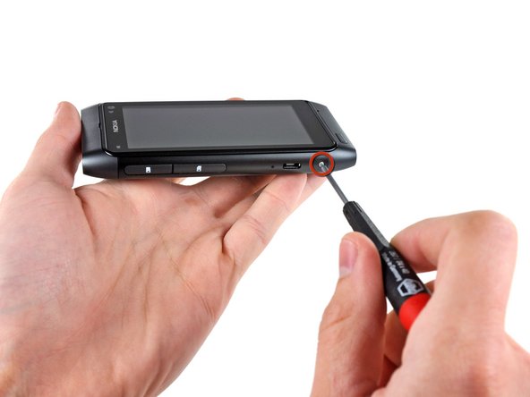

  • After popping off the protective cover, a T5 Torx screw near the mini HDMI port can be removed.
  • The top of the phone comes off next, exposing more Torx screws for us to remove.

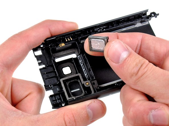

  • The loudspeaker can be pried off the adhesive securing it to the rear case at this point.
    • This loudspeaker is primarily used for speaker phone as well as for playing audio from media stored on the phone.

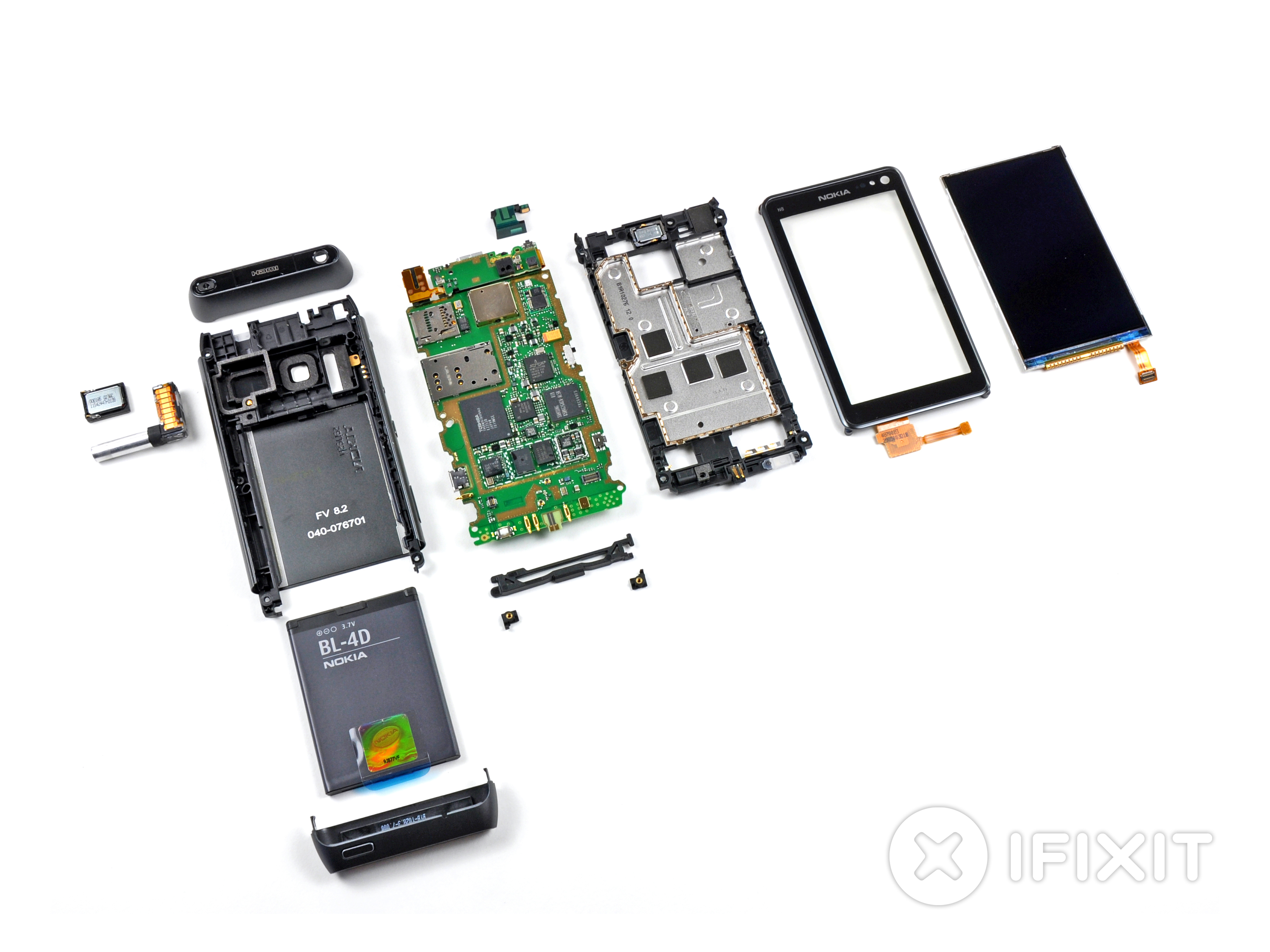

  • Nokia N8 Repairability: 8 out of 10 (10 is easiest to repair)
    • The battery, although considered by Nokia not to be user-serviceable, can be easily removed.
    • The AMOLED display easily comes apart from the glass, which means that you can replace the glass and the display independently.
    • There are mostly mechanical fasteners, and very little glue inside.
    • You still have to use a heat gun to remove the front glass, but at least you're heating up metal that won't deform as easily as plastic.
    • Removing the cameras is near-impossible, and requires tedious, potentially detrimental steps.

The two outer screws are T5 not T4 Torx
Geo, · Reply
"The top of the phone comes off next" in this tutorial only :-(
I was not able to go on the "t5 unscrew": top cover seems to be "solidly attached"
Roberto Venturi, · Reply
The cover is retained by 2 plastic lockers and needs some stress to pull off
http://d3nevzfk7ii3be.cloudfront.net/igi...
You need to apply a lot of pressure. For example by applying your thumbs on the back side of the cover and push in the back-to-front direction:
