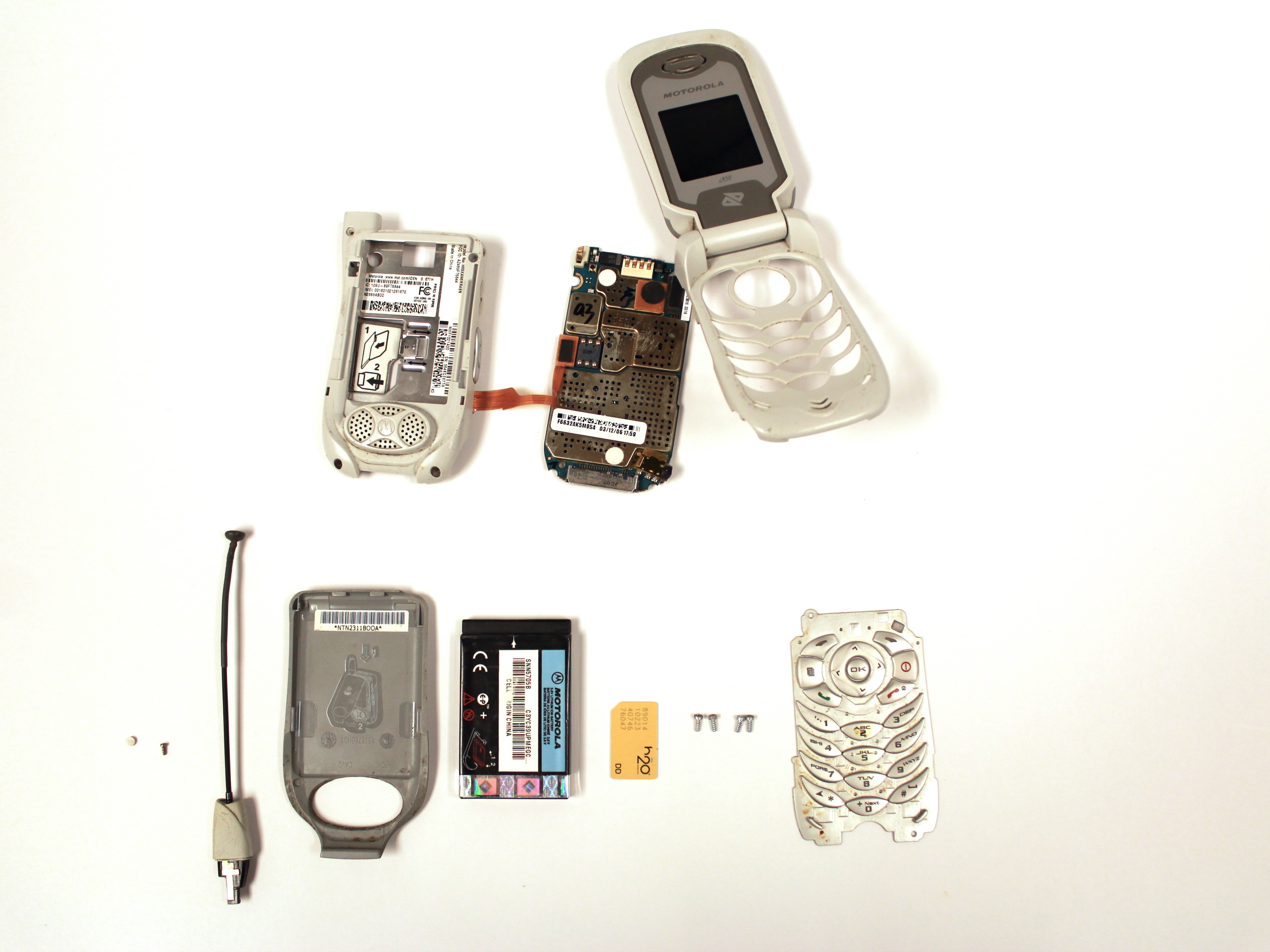

To gain access to any replaceable part, at least some of the disassembly outlined in this guide is required.
Place the phone on a flat surface with the front facing down and the antenna fully extended.
Use a spudger to remove the circular rubber cover from the base of the antenna.
Remove the 3.2 mm Torx T5 screw located under the rubber cover.
Place the phone on a flat surface with the front facing down.
Insert your finger under the gray plastic cover at the bottom end of the phone.
Lift the cover off the phone.
Place your thumb in the notch in the lower left corner of the battery compartment.
Lift the battery up and away from the phone.
Remove the battery.
Locate the metal slider that holds the SIM card in place.
Push the slider away from the metal flap which contains the SIM card. The flap will pop up.
Gently lift the end of the circuit board farthest from the phone hinge.
Grasp the keypad at the bottom of the phone, raise it, and pull it away.
