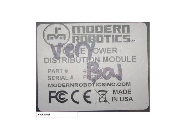

    • The words 'Very Bad' and 'Bad' does not come with the unit.

  2. Modern Robotics Inc. Core Power Distribution Module Deep Teardown: step 2, image 1 of 1
    • Back Label:

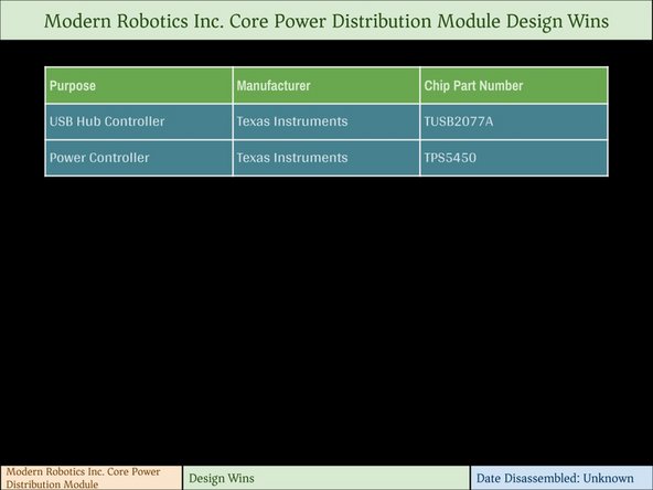

    • Main PCB Front Chip Identification:
    • Texas Instruments TUSB2077A 7 Port USB Hub Controller
    • Texas Instruments TPS5450 5A Step Down Converter
    • Texas Instruments TPS2044B 4 Channel USB Power Switch
    • Texas Instruments LP2985-N 16V Low-Dropout Voltage Regulator
    • Texas Instruments SN74LVC1G08 Single 2-Input AND Gate

    • Design wins for this device:
