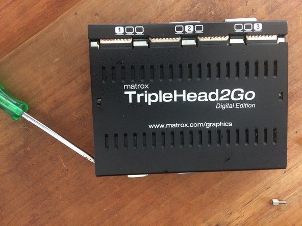

    • The first step is to unscrew all screws.
    • Second one is to insert something at the shown edge pull gently but firmly apart, alternating sides.
    • At the end, it will come off sideways.
    • It will be full of tiny copper pieces. Actually they won't be where you see them in the picture, but pulled off and laying around. You will need them to reassembly.
