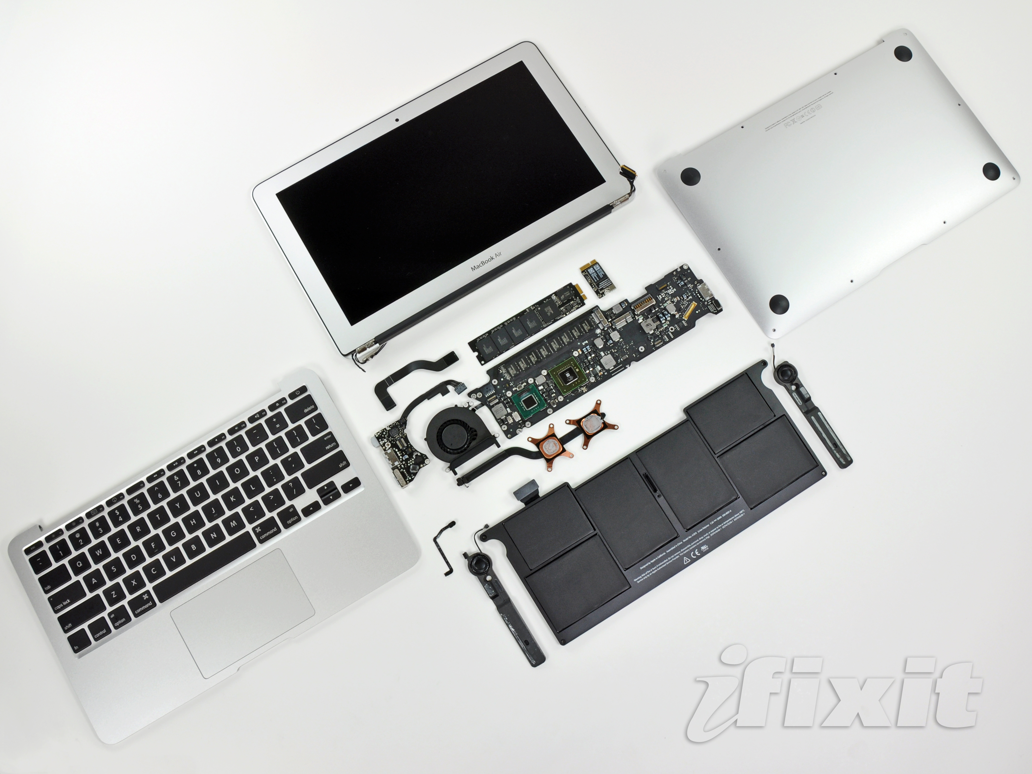

    • Lifting of the lower case after much struggling with those pesky case screws, we get our first look at the innards.
    • The inside of the MacBook Air is dominated by six individual lithium-polymer cells making up the 35 Wh battery.
  7. MacBook Air 11" Late 2010 Teardown: step 7, image 1 of 3 MacBook Air 11" Late 2010 Teardown: step 7, image 2 of 3 MacBook Air 11" Late 2010 Teardown: step 7, image 3 of 3
    • The large battery assembly is held in by five T5 Torx screws.
    • Apple claims that the battery will last up to five hours with active use, and up to thirty days in standby.
    • This battery is 35 watt-hours. Previous revisions of 13" MacBook Air machines have included 37 or 40 watt-hour battery packs. Since this Air has a smaller screen and lacks a spinning hard drive, we'd expect run time to be somewhat better than earlier Airs.

    • Three T5 Torx screws secure the fan to the upper case.
    • All of the cooling and ventilation in the MacBook Air is provided by the single squirrel cage fan.
    • It's thinner and tinier than the regular MacBook fans, just like everything else in this machine.

    • Three T5 Torx screws secure the ectomorphic logic board in place.
    • Like most recent Apple laptops, the heat sink comes out attached to the logic board. This is nice, as you'll only need to remove the heat sink and reapply thermal paste if you're replacing the logic board.
    • Unfortunately, like all previous MacBook Airs, the RAM is soldered to the logic board and is not upgradable. Apple does offer a 4GB RAM option at the time of purchase, but if you opt for only 2GB and decide you want more RAM later you'll be out of luck.
    • Our advice? Go for 4GB.
  14. MacBook Air 11" Late 2010 Teardown: step 14, image 1 of 2 MacBook Air 11" Late 2010 Teardown: step 14, image 2 of 2
    • After removing eight T5 screws, the thermal paste on the CPU and GPU is the only thing remaining that affixes the heat sink to the motherboard.
    • The heat sink on the new MacBook Air is considerably smaller than all previous models. It weighs only 10 grams. Based on the tiny heat sink, it seems that the Ultra-Low Voltage 1.4 GHz Core 2 Duo CPU is a cool chip.

    • MacBook Air 11" Late 2010 Repairability: 4 out of 10 (10 is easiest to repair).
    • Once you manage to take off the bottom cover, all the parts are pretty easily replaceable.
    • Opening the bottom cover is quite difficult if you don't have the right screwdriver. It's clear that Apple didn't want people to open their machine.
    • All the components -- including RAM and hard drive -- are proprietary, meaning that no off-the-shelf parts will work in it without serious rigging.
