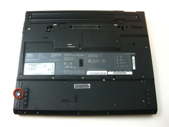

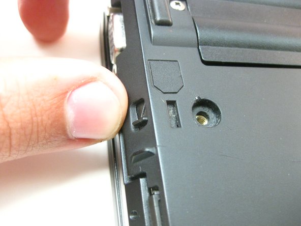

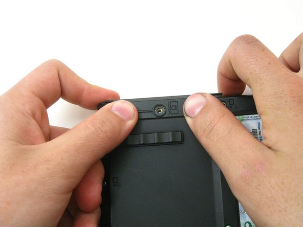

    • Removing the battery
    • Unplug the power cable before removing the battery.
    • Slide the 2 sliders on the under side of the laptop to the unlock position, as shown.
    • Grasp the battery and pull it straight out - not at an angle.

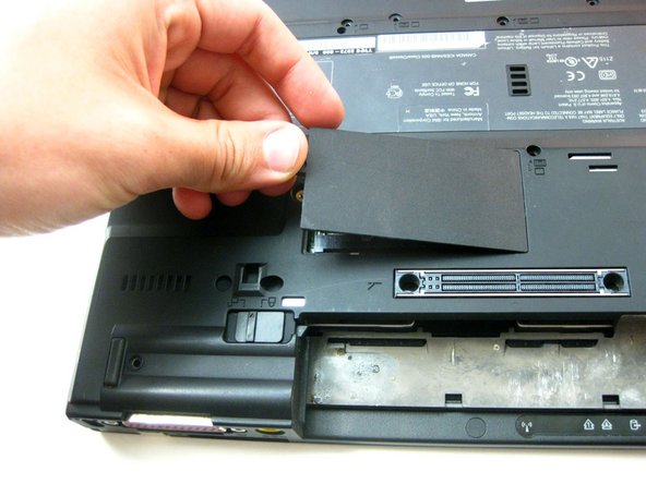

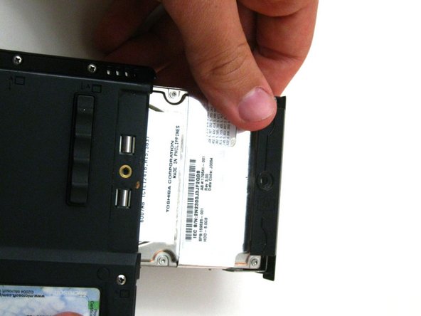

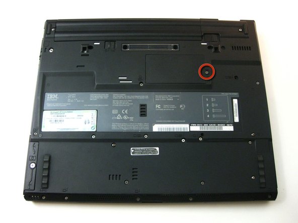

    • Removing the Hard Drive
    • Unscrew the screw holding the Hard Drive slot in place.
    • Pull the hard drive out with the help of pictured ridges. Cautiously maneuver it out - it might help to open the display slightly.

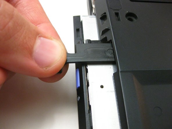

  3. IBM ThinkPad T42 Teardown: step 3, image 1 of 3 IBM ThinkPad T42 Teardown: step 3, image 2 of 3 IBM ThinkPad T42 Teardown: step 3, image 3 of 3
    • Removing the Optical Drive
    • Remove the screw holding the optical drive on the underside of the laptop
    • Push the small slider to unlock position, a tab will automatically pop out.
    • Pull tab to dislodge the optical drive, then pull the drive out.

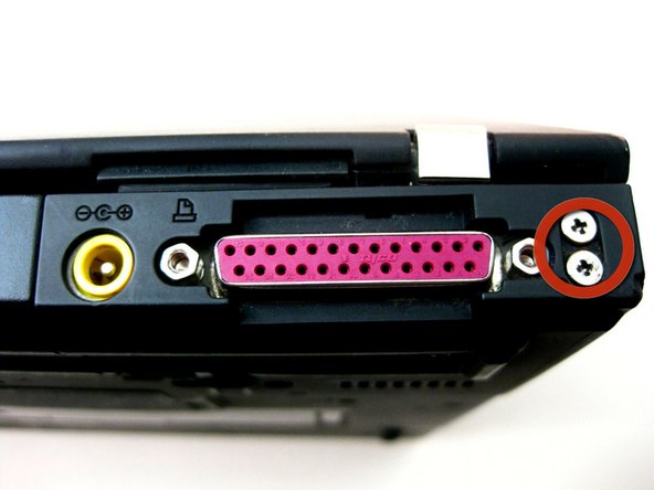

  5. IBM ThinkPad T42 Teardown: step 5, image 1 of 3 IBM ThinkPad T42 Teardown: step 5, image 2 of 3 IBM ThinkPad T42 Teardown: step 5, image 3 of 3
    • Removing Rear Cover
    • Unscrew the rest of the screws on the underside of the T42.
    • Unscrew the 4 screws on either side the rear end of the laptop.
    • Note: for ease of reassembly, keep track of which screws go where.

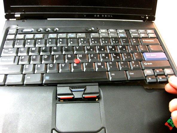

    • Removing Keyboard and Trackpad
    • Flip the laptop over and open the display carefully - the keyboard, palm rest and bezel will be loose.
    • Maneuver the palm rest away from the keyboard carefully, both the keyboard and palm rest/trackpad will come off together.
    • **WARNING** Both the keyboard and trackpad have connectors to the motherboard. Disconnect these before completely removing either component.

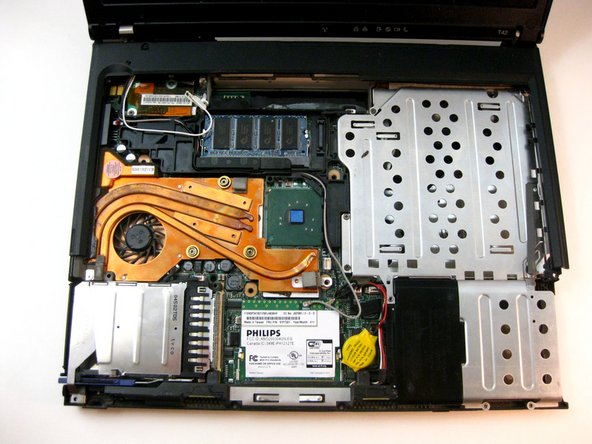

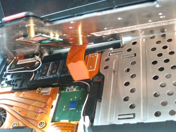

    • From here you can remove multiple components.

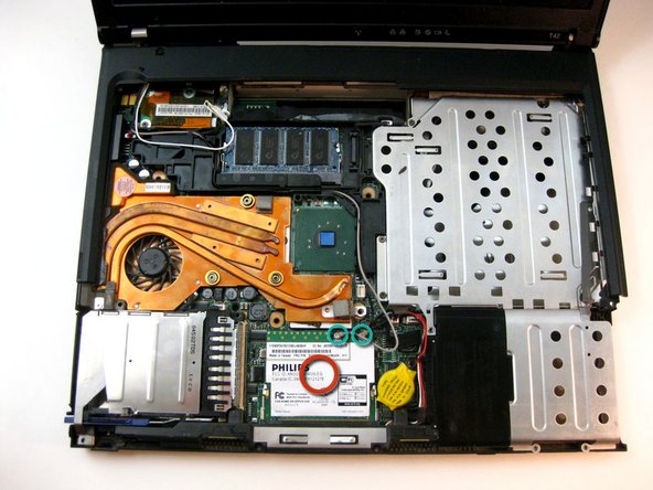

    • Removing Wi-Fi Card
    • To remove Wi-Fi card, first disconnect both display wires on the top right.
    • Then slide both of the metal pieces holding it down outwards, and it will pop up.
    • Carefully pull it out.

    • Removing Mini-PCI Port
    • Unscrew the screw holding the port's bracket down, then remove the bracket.
    • Carefully disconnect it from the motherboard.

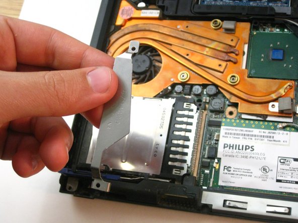

    • Removing Modem Daughter Card
    • Unscrew three phillips screws as shown.
    • The connector cables are wrapped around components for organization so follow these, unplug them and carefully pull them free.
    • Then remove the bracket that was sitting beneath it.

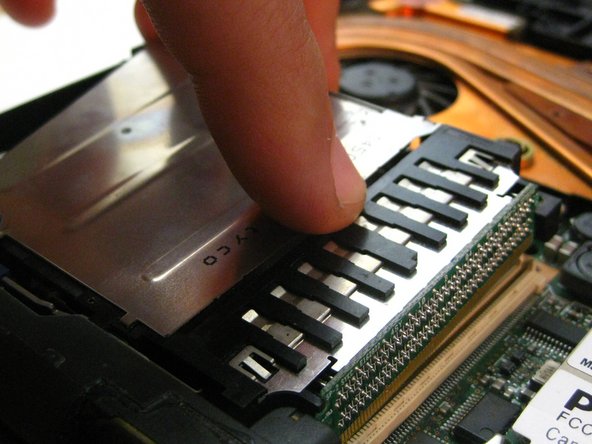

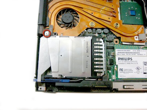

  16. IBM ThinkPad T42 Teardown: step 16, image 1 of 3 IBM ThinkPad T42 Teardown: step 16, image 2 of 3 IBM ThinkPad T42 Teardown: step 16, image 3 of 3
    • Removing Metal Casing
    • Unscrew the Philips head screws as shown
    • It is attached to the smaller black plastic piece below it - carefully maneuver both of them out at the same time.
