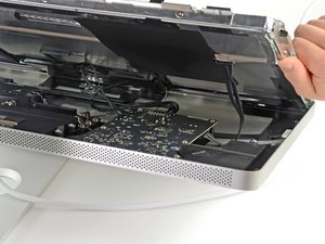

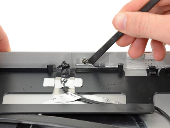

Image 1/3: A few connectors and a ground screw are all that prevent the freedom of the LCD.
  • It's time to take a look under the hood. With the help of our 54-piece bit driver kit, we liberate a few screws (12 to be exact, but who's counting?) from their asylum.
  • A few connectors and a ground screw are all that prevent the freedom of the LCD.
There are three ribbon cables to disconnect before you can lift the display up to access the screw for the ground wire. The middle picture is misleading, at least on my monitor--you could only tilt up the display panel a couple of inches before you put strain on the ribbon cables. (Not a fan of this writing style at the expense of useful detail)

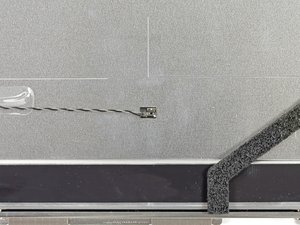

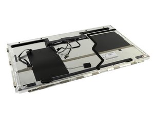

Image 1/3: DisplayPort
  • The back of the LCD display has only a few cables, none too exciting:
    • DisplayPort
    • LED backlight
    • LED backlight sync
    • Ground loop.

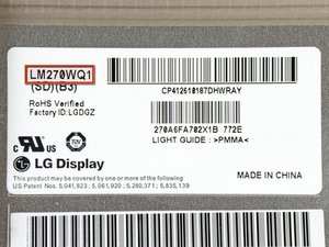

  • The LG display reads model number LM270WQ1. Is it possible that we may have seen this model number before?
  • Yes, it appears to be the same display found in the iMac Intel 27" from October of 2009, as well as the same basic LG display found in Dell's competing 27" monitor, though the Apple version uses LED backlights as opposed to Dell's traditional CCFL.
  • Dell's version is also matte, something that lots of Mac users have been harping for once the old 30" Cinema Display was phased out.

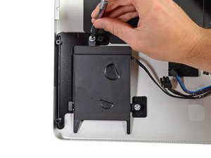

Image 1/3: Apple has, as usual, chosen to go with a large, brushless fan to keep the colossal Thunderbolt Display nice and cool.
  • The fan is easily removed simply by detaching a couple of connectors and unfastening a few screws.
  • Apple has, as usual, chosen to go with a large, brushless fan to keep the colossal Thunderbolt Display nice and cool.

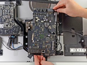

Image 1/3: A few more T10 Torx screws bite the dust at the hand of our bit driver kit, and the logic board is detached.
  • In our pursuit of self-preservation, we begin by disconnecting the power supply connector from its socket on the logic board to prevent any electrifying experiences.
  • A few more T10 Torx screws bite the dust at the hand of our bit driver kit, and the logic board is detached.

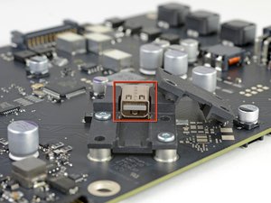

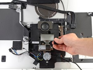

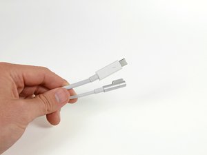

Image 1/3: A few T6 Torx screws are knocked out to remove the connector cover, and the Thunderbolt cable is disconnected.
  • Stop—it's connector time! We remove a plethora (that's right, plethora, we're using our five dollar words) of connectors from the logic board, leaving only the brains behind the Thunderbolt port between us and the display's control center.
  • A few T6 Torx screws are knocked out to remove the connector cover, and the Thunderbolt cable is disconnected.
  • Interestingly enough, the Thunderbolt cable that routes into the display also plugs into a standard Thunderbolt socket on the logic board. Apple could have just soldered the cable wires to the board, but instead chose to implement a cover that prevents the cable from being detached from the logic board's Thunderbolt socket.
When upgraded (optical) Thunderbolt cables become available, it will conceivably be possible to upgrade the display by replacing the cable. Remember, the transceiver is in the cable.

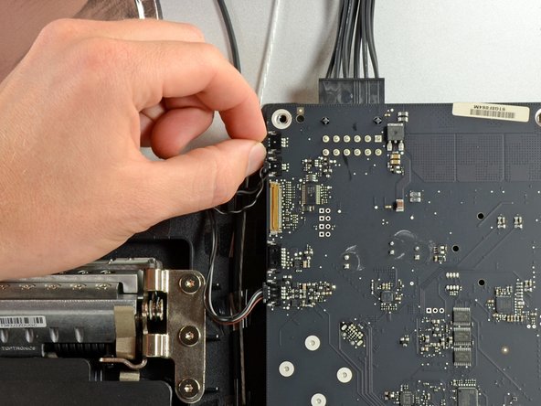

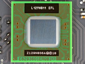

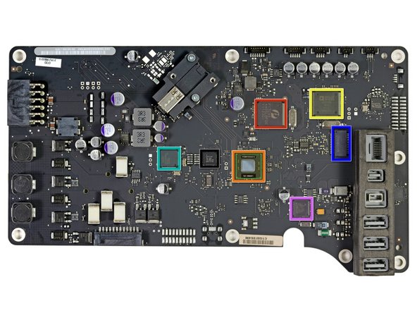

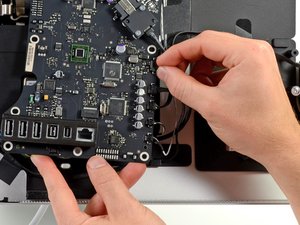

Image 1/2: Pericom [http://www.pericom.com/products/pci/PI7C9X440SL/|PI7C9X440SL] PCIe-to-USB 2.0 host controller
  • St. Damien's beard! The front of the logic board includes these stellar packages:
    • Pericom PI7C9X440SL PCIe-to-USB 2.0 host controller
    • L129NB11 EFL, which looks to be the Thunderbolt port controller (as viewed in the second picture)
    • Analog Devices ADAV4601 audio processor
    • NXP LPC2144 USB 2.0 microcontroller
    • Delta LFE9249 10/100/1000 Base-T LAN filter
    • SMSC USB2517-JZX USB 2.0 hub controller
    • LPC 1114F
It's interesting to see the TB circuit board. Have you tried to find an Apple P/N for this board? In your opinion, is this what a vendor would need to simulate to build their own TB breakout box (along with a power supply)? Vendors keep saying it's going to be expensive to implement TB. From the looks of this circuit board, I might agree, however the range of I/O devices you get on this board is amazing.
plink53 - Reply
Dose any body now, what the tow other both pin sections do (behind the LCD-Connector and under the output connections)?
or in other words: is there any changes to connect a HDMI or DVI-Display directly at the board (so, that you can use the Thunderbolt for other devises)?
cyrills - Reply
The LPC2144 also generates the three PWM signals for the HV9982.
(and - I guess - the EDID codes ans misc. others).
This is interesting, because I suspect this chip to be the culprit in the cases of failing backlight.
If it holds no firmware, it should be quite straightforward (and cheap) simply to replace the chip.
3bbe - Reply
This is the case with the LED Cinema Display, anyways...
3bbe - Reply

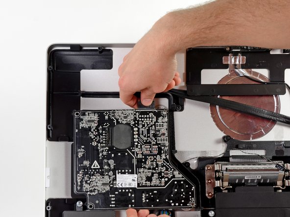

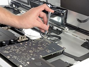

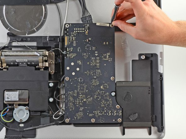

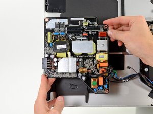

Image 1/3: A few screws and connectors are all that are stopping us from removing the board.
  • With the logic board removed, we move on to the power supply board.
  • A few screws and connectors are all that are stopping us from removing the board.
  • We make quick work of them and the Flextronics power supply board comes free.

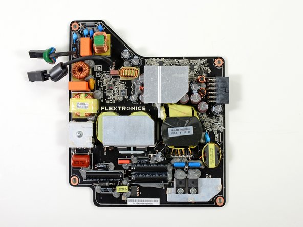

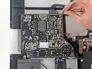

Image 1/2: How about 250 watts of maximum continuous power -- is that enough for you?
  • Hot pot of coffee! Let's see what the Thunderbolt Display's power supply board can do for us.
  • How about 250 watts of maximum continuous power -- is that enough for you?
    • Fun science fact, the "thunderbolts" (AKA lightning) in nature can put out an average of 1,000,000,000,000 watts, that's 4 billion times the output of the Thunderbolt Display's power supply! But lets be fair...lightning bolts are much, much larger than this power supply and last only fractions of a second.
Apple now has a revised version of this power supply that looks slightly different, so newer Thunderbolt displays are not all alike. Not sure if the older power supply is any better or less prone to failure like the newer boards are.
Jim - Reply

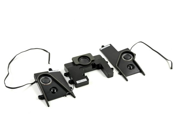

Image 1/3: Wait! What have we here? Is that a built-in 1-inch subwoofer, as well?
  • We see some fairly large speaker enclosures (well, for a monitor) near the side edges of the Thunderbolt Display and eagerly remove the screws holding them in place.
  • Wait! What have we here? Is that a built-in 1-inch subwoofer, as well?
  • The Thunderbolt Display comes with a 49 watt 2.1-speaker sound system, including a miniature subwoofer.

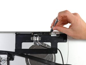

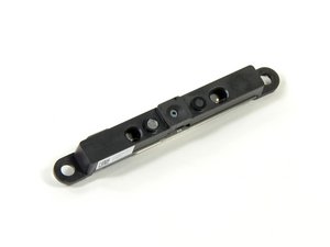

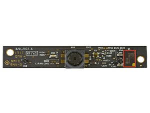

Image 1/3: Yoink! Out comes the camera and its ability to record video up to 720p, as well as its ability to support widescreen 16 x 9 aspect ratios.
  • A couple screws and a single connector keep the HD FaceTime camera secured to the case.
  • Yoink! Out comes the camera and its ability to record video up to 720p, as well as its ability to support widescreen 16 x 9 aspect ratios.

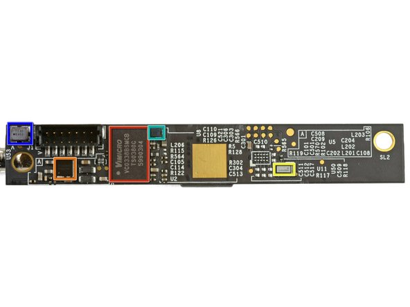

Image 1/2: cFeon LV010-45RNIP 11113A 1110ADA
  • The front side of the camera board:
    • cFeon LV010-45RNIP 11113A 1110ADA
  • The rear side of the camera board:
    • Vimicro VC0338BSMCB Camera Controller
    • Texas Instruments TPS65708 Power Management Unit
    • 0BNHM7
    • 408F N109
    • T120 Bd01

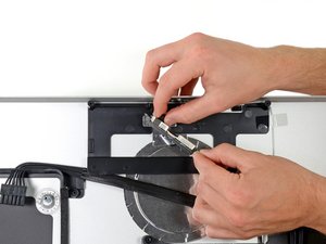

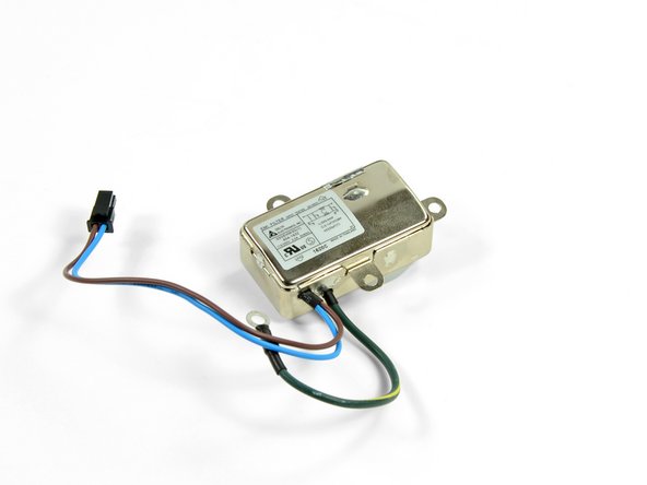

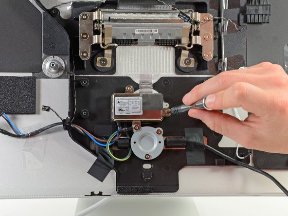

Image 1/2: The AC-Inlet in all its infinite glory.
  • Uncle Jonathan's corn cob pipe! Just a few Torx 10 screws stand between us and the AC power adapter.
  • The AC-Inlet in all its infinite glory.
  • Hey Mic, you seem like you're in a tight spot. Here, let me help you out.
  • Good ol' spudger would never let a friend like Mic down.

OMG, through hole components on the power supply board! And hand smeared silicon glue! How could 20 years of technology gap exist in a leading Apple product? Bob, that Flextronics board needs to come off. I'm not buying until then.
Casey Norway - Reply
Every SPS is using the glue to pass the safety, you can choose not to buy anything with a SPS
Floyd Tsui -
Would you like to try developing a SMPS, which has to deal with hundreds of watts of current, using only surface mount components? Go on, give it a try. We will wait.
Walker Quine -
