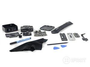

Apple fans are doing the happy dance, what with a slew of new devices coming out of Cupertino—including the first new Apple TV in more than three years. Our teardown engineers look pretty happy too. That's because we've got our hands on a 4th generation Apple TV. That's right, kids. It's teardown time!
Don't touch that dial—unless you're looking for more teardown news on our Facebook, Instagram, or Twitter.
We like to start with some specs, and in this case a lot of the good stuff is packed into the fancypants new remote. The box itself contains:
Dual-core, 64-bit Apple A8 chip
Ethernet, 802.11a/b/g/n/ac Wi-Fi, IR receiver, and HDMI 1.4 connectivity
...whilst the remote is packing:
Glass Touch surface
Dual microphones
Accelerometer and gyroscope
Bluetooth 4.0, IR transmitter, Lightning connector

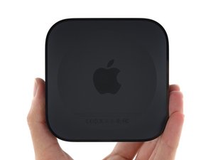

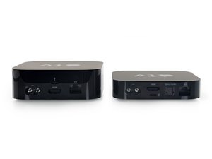

The Apple TV has really packed on some pounds since its last iteration.
It seems to have lost a port in the process—the optical audio out has gone MIA.

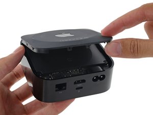

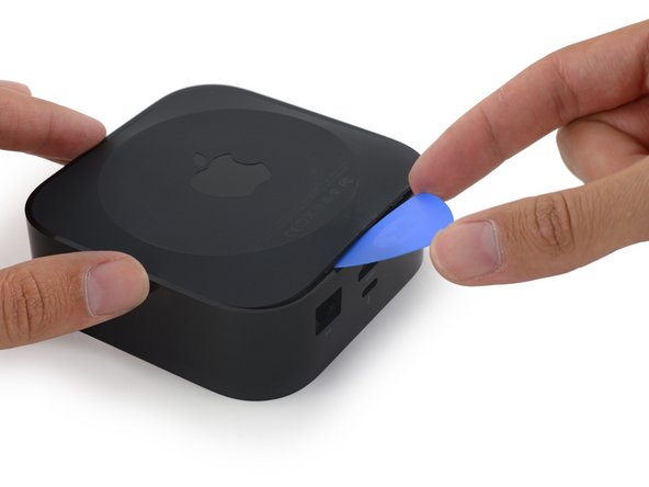

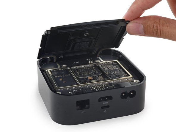

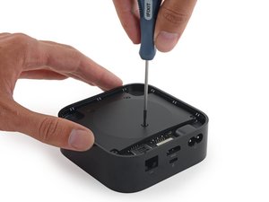

Our teardown engineers go to work on the Apple TV and quickly find access through the bottom of the device—similar to the 3rd generation Apple TV.
Only a few plastic clips stand in the way here, with no adhesive or screws in sight.
Under the hood, we spy a few Torx screws.
We take our Pro Tech Screwdriver Set out for a quick spin to release the combo heat sink/EMI shield.
By the looks of it, this plate also serves as a bracket, giving the clips on the lower case something to latch onto. That's three functions in one component, folks.

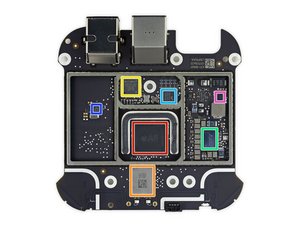

Here are some chips to go with your TV:
Apple A8 APL1011 SoC, with SK Hynix H9CKNNNBKTBRWR-NTH 2 GB LPDDR3 SDRAM
Universal Scientific Industrial 339S00045 Wi-Fi module
SMSC LAN9730 USB 2.0 to 10/100 Ethernet controller
Apple 338S00057 (similar part number to the 338S00055 custom memory controller found in the Retina MacBook 2015)
DP2700A1
Texas Instruments PA61
Fairchild Semiconductor DF25AU 010D 030D
Is it possible the Apple 338S00057 is a power management IC? The NAND flash controller is typically integrated into the SoC, and the parts surrounding the 338S00057 look like chokes or inductors.
I would agree with you. The caps/inductors completely surrounding that smell a lot like a PMIC.
The DP2700A1 has a Marvell logo on it. Any guesses to what this is?
Since the SMSC USB to 10/100 Ethernet has an integrated PHY, I'm guessing this is an HDMI interface IC (Either a level shifter, cable driver/ equalizer, or ESD/port protection). Maybe a Maxim part?
It's MegaChips, not Marvell. Looks to be from their range of DisplayPort converters. Probably an eDP to HDMI 1.4 converter. Doesn't appear to be the full blown MCDP2800 DP 1.2a to HDMI 2.0 LSPCON ( http://www.megachips.us/products/documen... )
So the 2800 definitely has 4K support, I couldn´t find any spec on DP2700A1 so we don´t know about that...Could this be an Apple specific version? It shouldn´t be too hard to buy with this with a purchase volume of 10 - 30 million...It seems that this chip has the definite answer to if 4K is possible on the hardware...
Why only 10/100 ethernet and not Gigabit ethernet? I would think anyone considering buying this would think it is easily worth the extra few cents. 4k video requires 15 - 32 Mbps depending on quality, so why not use Gigabit to give more headroom on the bandwidth?
3-6 times headroom isn't enough? Seeing as though the majority of users will be streaming from the Internet, and the majority of those users don't even have 100Mbps or higher connections.

It would be interesting to Ohm out the connection to the HDMI connector to see if it connects directly to the A8 CPU, or if it is possibly connecting to the 338S00057 chip. This would tell us if the A8 has HDMI built in, or if Apple is using a 2nd chip to create HDMI from some other signal like LVDS or Lightning serial.
Looking closer, it seems obvious that the DP2700A1 chip has the HDMI traces connected to it, so this is apparently some kind of HDMI transmitter? Does anyone know who makes this chip? It has a large M on the chip, which may be a clue to the manufacturer.
The big question here is if this chip has 4K capability (without current SW support from Apple)?

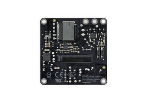

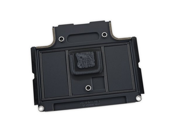

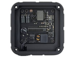

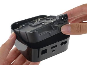

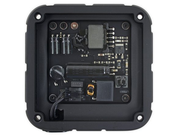

Last to come out of the box: a great big chunky heat sink with a cute little power supply board tucked away inside.
The redesigned power supply is rated at 12V at 0.917A. Compare that to the 3rd-gen Apple TV's main reactor, which pumped out 3.4V at 1.75A.
We noticed a distinct lack of cables connecting the power supply to the logic board. We're theorizing the power is either transmitted by magic, or through the heat sink screw posts.
Heat doesn't rise. Heated fluids rise because of their decrease in density relative to cooler fluid.
But heated air rises...
So on earth—unless you are in a vacuum—heat rises.
On the second picture showing the innards of the power supply, it looks like on the top left the bare screw delivers the power (you can see there's a PCB tracing coming off the cap to it) and the black screws are either for mounting or chassis return.
And looking at the heat sink, some of the posts appear to make contact with the metal rings around the through holes where they would line up, indicating the heat sink's use as a ground plane.
I have to admit, this is creative engineering.
Yes, it looks like power goes through the silver screw at the top, and another screw that is hidden under the power supply clip? You can see on the circuit board where the screw has made physical contact.
Plase expand about power supply. I need to know if it's multi-voltage. I Live in Chile, a friend is travelling to US and I want him to buy an Apple TV. Here in Chile we use 220V 60Hz.
Edison - if you zoom in on the 3rd photo in step 6 there's printing on the board that says "100-240V, 50-60Hz"
It's disappointing that Apple's tech info doesn't state that, or the power consumption, but practically every electronic device now can accommodate either 120 or 240 VAC.
You say "The redesigned power supply is rated at 12V at 0.917A. Compare that to the 3rd-gen Apple TV's main reactor, which pumped out 3.4V at 1.75A."
What you didn't say is: "The 3rd generation Apple TV consumed 5W of power, while the 4th generation consumes over twice as much at 11W."
The way you stated it sounds like maybe you were trying to spin it.
Where can I get a replacement power supply?
Are the power supply separated so I can connect 12 VDC to in instead Lv 230 VAC?

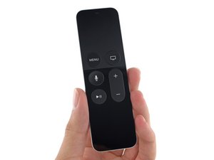

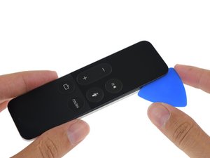

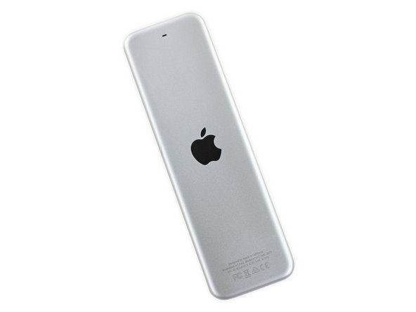

Behold, the new Siri Remote! Featuring dual microphones, a Glass Touch surface, and a Lightning connector, this remote is definitely a bit more complex than the Apple Remote of yesteryear.
Apple also packed in an accelerometer and gyroscope, which they hope you'll use to play games—and browse Airbnb.
With Bluetooth 4.0, the new Remote doesn't need direct line-of-sight with your TV.
That is, unless you want to control your actual TV. Apple points out that the remote for their new TV can also control a television or A/V receiver.
Doesn't the ATV control the TV via HDMI? I don't think Apple uses infrared, so you shouldn't need to be in the line of sight as mentioned in the article.
Correct me if I'm wrong.
You're wrong, partly. The remote uses infrared for volume control on the TV, Bluetooth to talk to the Apple TV and CEC via HDMI for everything else.
Thanks for your detailed info!
Why would they use infrared for the TV volume only? That's, like, THE most basic of all HDMI-CEC commands! Not to mention that making it a programmable IR remote adds a whole other level of complexity to initial setup. Is it conceivable that the IR transmitter has some other purpose?
To adjust the volume on a connected stereo system as well. (...and it works, too.)

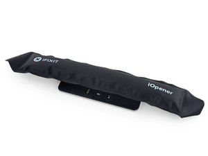

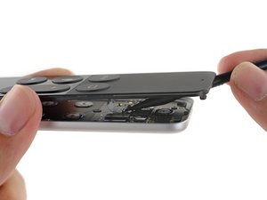

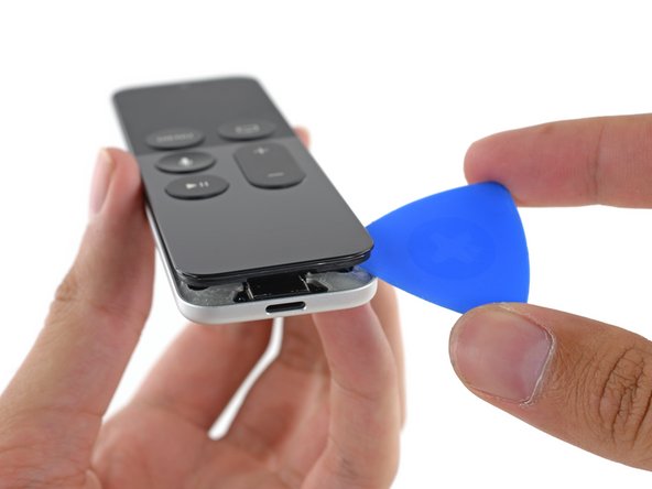

We found where Apple was hiding all the adhesive! Looks like our iOpener and pick don't get the day off after all.
The entire top end of the remote is a giant button. Beneath it lies a gap that gives us a nice, consistent groove to pick apart.
"Hey, Siri—say Ahhhh."
If only it was that easy... Actually, it was pretty easy. It seems there's a first for everything!
We're suddenly having flashbacks to the iPhone 5s. The top half is connected by a ribbon cable, hidden in the center of the device.
Our in-house EOD expert gets to work with a spudger and carefully disarms the trap.
With the top and bottom separated we notice a hidden yin yang motif. That's so zen of you, Apple.

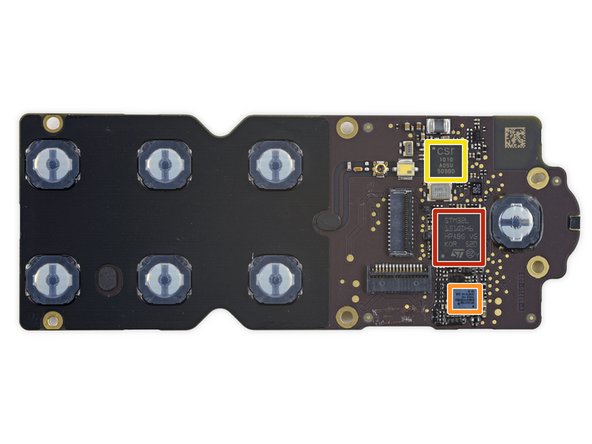

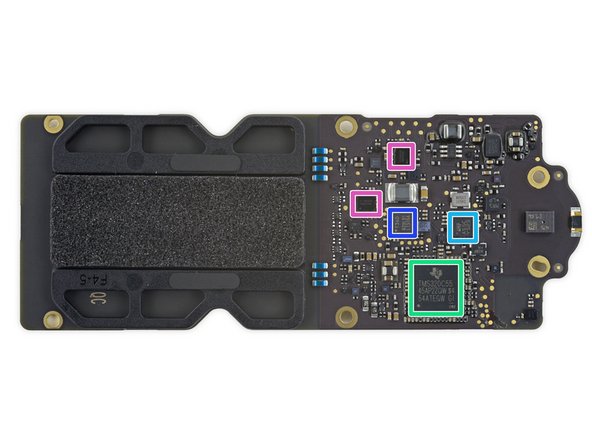

OICURAQT—That's what we say whenever we identify an IC, like the ones on this logic board:
ST Microelectronics STM32L 151QD ultra-low-power ARM Cortex-M3 MCU
Broadcom BCM5976C1KUB6G touch screen controller (as seen in the iPhone 5s/5c and iPad Air)
CSR (Qualcomm) CSR1010 Bluetooth radio
Texas Instruments TMS320C55 ultra-low-power digital signal processor
ST Microelectronics AS5C Y523
InvenSense ITG-3600 3-axis gyroscope
Texas Instruments BQ24250C battery charger and TI 49C37GI
I think the DSP link is wrong - TI think that the 320 is a C6000 series, not a C5000 series.
It's pretty %#*@ amazing that this remote control has more CPU power that a mid-90s PC (although I'm sure it mostly runs in a deep sleep state).
Ah, nope, TI are just trying to upsell me I think. A better link is http://www.ti.com/lsds/ti/processors/dsp...
Only a gyro is very unlikely, where is the accelerometer? Who can find it? Seems that INVN accel+gyro is not in it
Is there an IR LED? If so, does anyone know the frequency output?

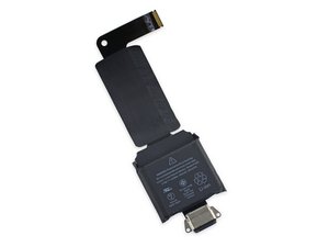

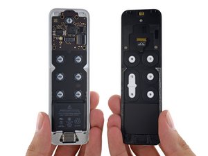

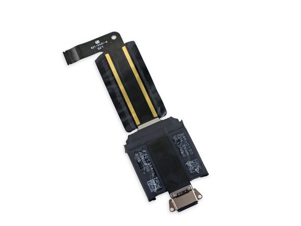

Look at that! A ZIF connected Lightning port cable.
If Apple can pack a ZIF connector into a tiny remote like this then why is the iPad Lightning port soldered to the logic board?
Answer: Apple proprietary secret.

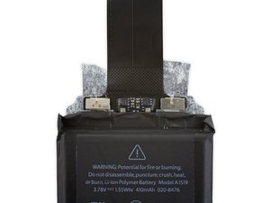

With just a bit of glue to pick apart, the Lightning cable/battery is out in a flash.
With the Lightning port/battery assembly free of the remote, we see that the battery is soldered to the Lightning port.
While we've never been a fan of soldered-on batteries, at least the Lightning port isn't soldered to the logic board!
Because this 410 mAh battery is rechargeable, you'll never scramble to find batteries for your TV remote again. Thanks, Apple!
At least not until it dies and you need to replace it.
My battery has died, just after the warranty expired. What are my chances of a replacement?

The power supply is a separate, replaceable component, and even its AC-in jack is modular.
