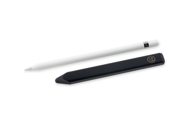

    • There's been a lot of talk about Pencil. Let's sketch out a couple quick comparisons to some other styling styluses.
    • First: the Microsoft Surface Pen (from a Surface Pro 4).
    • Second: The original "iPad Pencil" by 53. It works specifically with their Paper app, and has a lot of the same features as the new Apple Pencil.
    • Also, it's really easy to open up and get the battery out.
    • Double-also, it has an eraser.

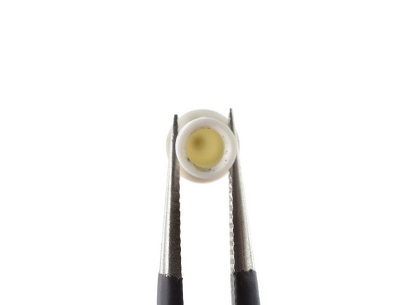

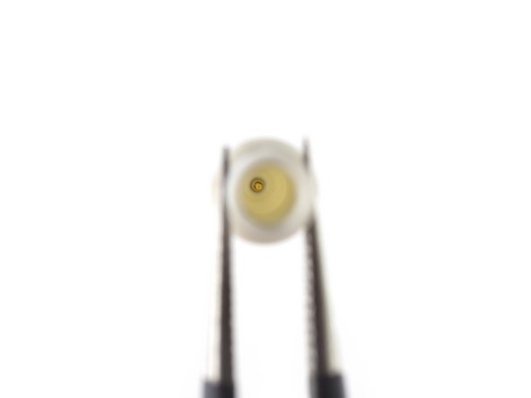

    • Taking a nosedive into the Pencil, we start at the nib, which comes off quietly with a few quick twists.
    • A peek inside reveals a tiny metal bit sunk deeply into the tip, presumably to get as close to the screen as possible.
    • This likely connects to one of the two emitters in the tip that allow the iPad Pro to determine the Pencil's angle and orientation relative to the display, and adjust the pen stroke accordingly.
    • The digitizer on an iPad Pro should be able to determine the distance from each emitter to the screen—and from that calculate the angle of the Pencil relative to the iPad.

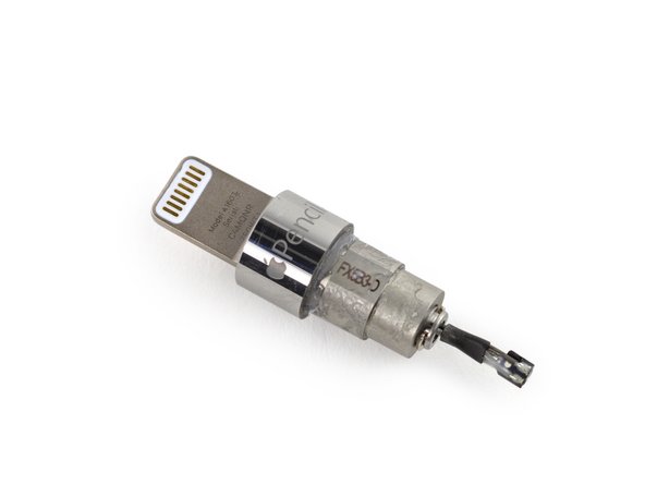

    • We're eager to get a closer look at the eraser Lightning Connector, so we turn up the heat with our trusty iOpener.
    • Author's note: the fact that they bothered to call this the Pencil—and not the Pen/Stylus—and then failed to include an eraser is just absurd.
    • Even after a warm conversation with our iOpener, the Lightning Connector assembly still doesn't want to come completely out of its shell, but a quick tug frees it from the Pencil.
    • But at what cost... We definitely tore a flex cable...
    • Something tells us this isn't going to be one of those teardowns where everything goes back together at the end.

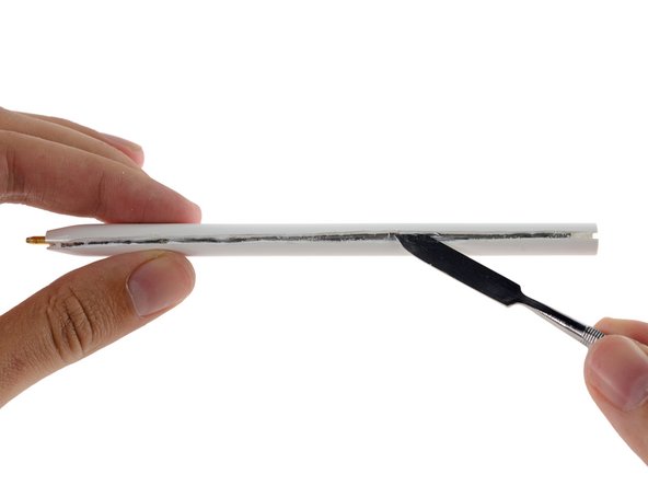

    • Having thoroughly dissected the top and bottom portions and finding no obvious point of entry, we throw caution to the wind and break out the big guns.
    • Cutting through the Bic Apple Pencil's plastic casing reveals an ink cartridge a metal casing.
    • And we haven't punctured the battery...yet! Looks like our Operation skills are finally paying off.

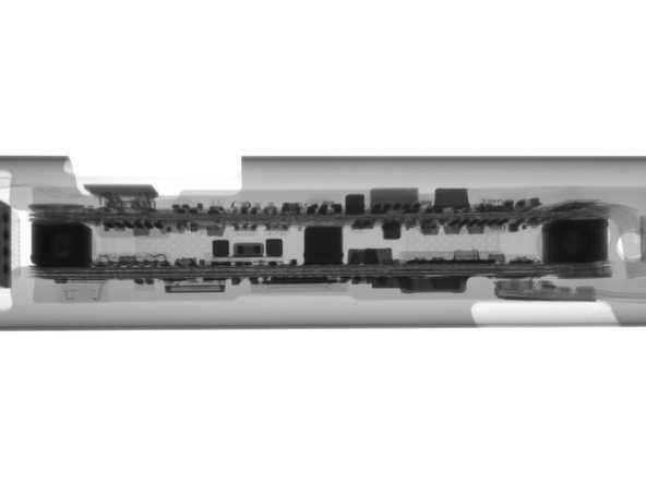

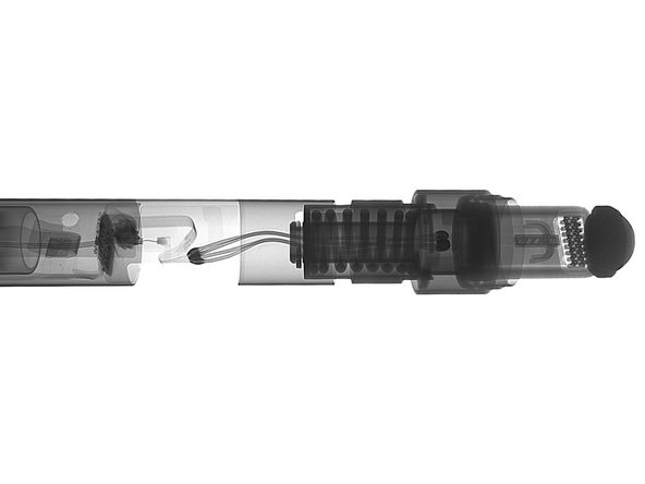

    • Further teardown of the tip seems impractical, but that's okay: we have eyes everywhere, thanks to some slick X-ray imaging from our pals at Creative Electron.
    • Get a load of that tiny spring-loaded tip, and the two emitters buried within the shaft.
    • Just for kicks, we also imaged the itty bitty folded logic board, and the Lightning Connector and cap.
    • Fortunately this was captured when the Pencil was still intact, so you can still see the connector neatly soldered to its little ribbon cable. It's a thing of beauty (at least until the day you need to repair something).
