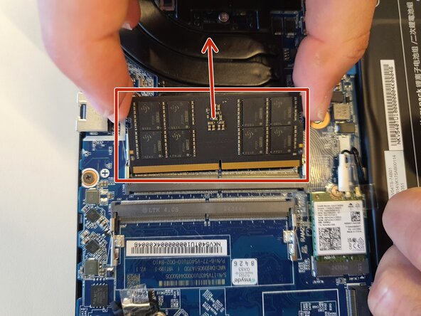

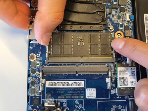

    1. why! V540TU RAM Replacement, RAM: step 4, image 1 of 3 why! V540TU RAM Replacement, RAM: step 4, image 2 of 3 why! V540TU RAM Replacement, RAM: step 4, image 3 of 3
      • Spread the two metal arms apart.
      • Remove the RAM.
      Ask FixBot
