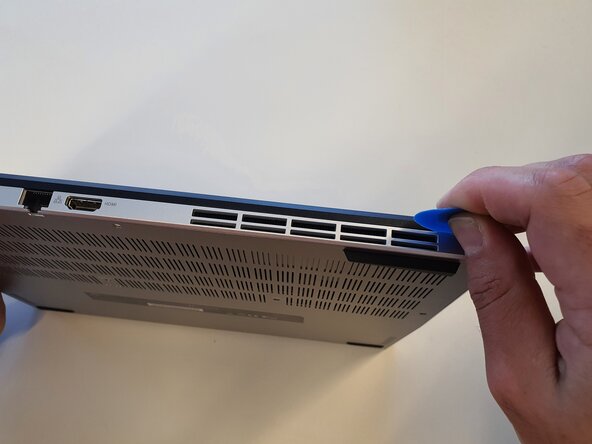

      • Unscrew the screws circled in red.
      • Insert the opening pick into the gap and slide it all the way around.

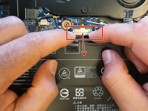

    1. why! V540TU Keyboard Replacement, Battery cable: step 3, image 1 of 1
      • Unplug the cable.
