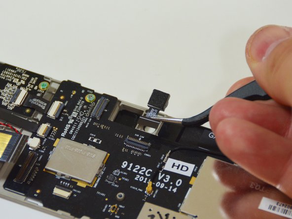

    1. why! Tablet Front Camera Replacement, Front camera: step 7, image 1 of 2 why! Tablet Front Camera Replacement, Front camera: step 7, image 2 of 2
      • Locate the front camera module connector on the motherboard and disconnect it using the opening tool.
      • Gently remove the front camera module from its housing.
      Ask FixBot
To reassemble your device, follow the instructions in reverse order.
