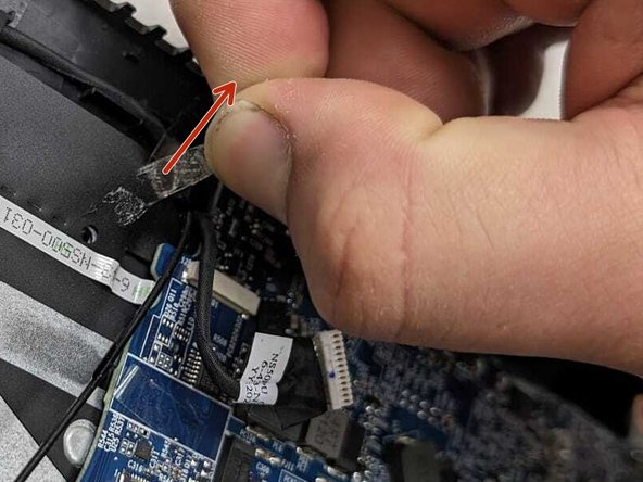

    2. why! NS5xAU Screen Replacement, Separation 2: step 8, image 1 of 3 why! NS5xAU Screen Replacement, Separation 2: step 8, image 2 of 3 why! NS5xAU Screen Replacement, Separation 2: step 8, image 3 of 3
      • Peel off the adhesive.

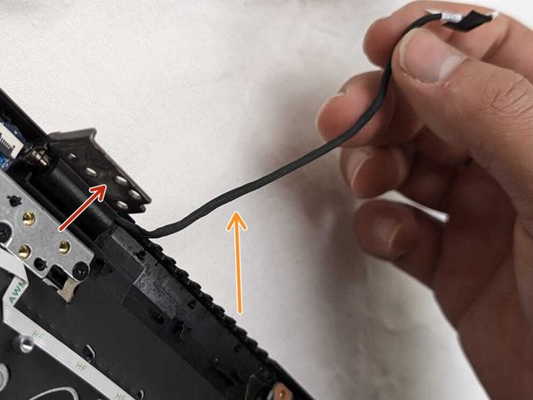

    3. why! NS5xAU Screen Replacement, Separation 3: step 9, image 1 of 2 why! NS5xAU Screen Replacement, Separation 3: step 9, image 2 of 2
      • Lift the clutch hinges.
      • Remove the cables from the lower module.

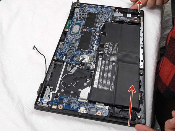

    4. why! NS5xAU Screen Replacement, Step 4: step 10, image 1 of 3 why! NS5xAU Screen Replacement, Step 4: step 10, image 2 of 3 why! NS5xAU Screen Replacement, Step 4: step 10, image 3 of 3
      • Lift the lower module to a 90° angle.
      • Release the lower module.

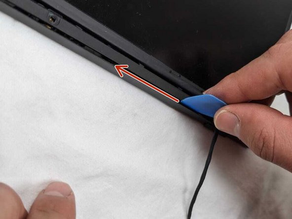

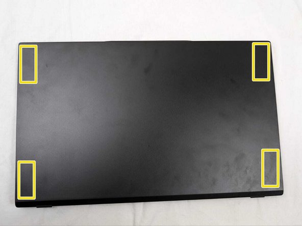

    1. why! NS5xAU Screen Replacement, Frame 1: step 11, image 1 of 3 why! NS5xAU Screen Replacement, Frame 1: step 11, image 2 of 3 why! NS5xAU Screen Replacement, Frame 1: step 11, image 3 of 3
      • Insert the opening pick into the frame seam and slide it around the edge.
      Ask FixBot

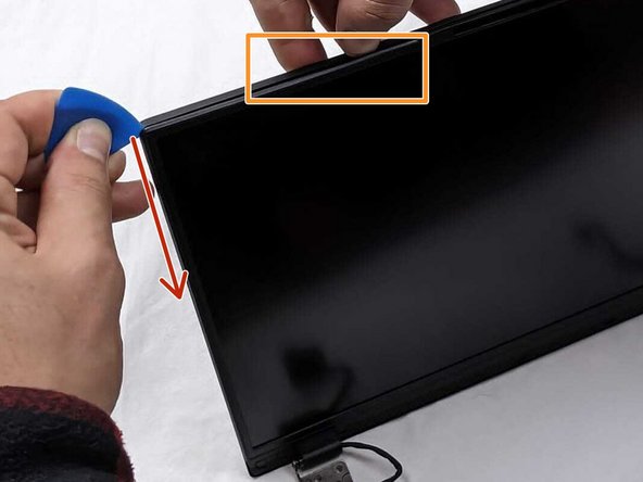

    2. why! NS5xAU Screen Replacement, Frame 2: step 12, image 1 of 3 why! NS5xAU Screen Replacement, Frame 2: step 12, image 2 of 3 why! NS5xAU Screen Replacement, Frame 2: step 12, image 3 of 3
      • Slide the opening pick from top to bottom.
      • Unclip the top of the frame.

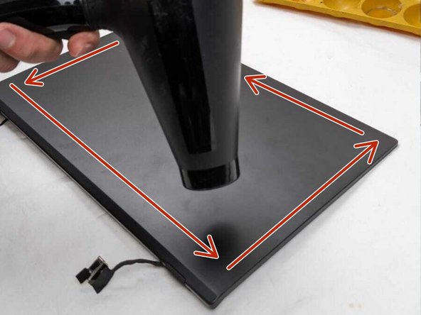

    1. why! NS5xAU Screen Replacement, Screen 1: step 17, image 1 of 3 why! NS5xAU Screen Replacement, Screen 1: step 17, image 2 of 3 why! NS5xAU Screen Replacement, Screen 1: step 17, image 3 of 3
      • Use the hair dryer to soften the adhesive strips on the screen.
      • Do not stay in one spot for too long.
      Ask FixBot

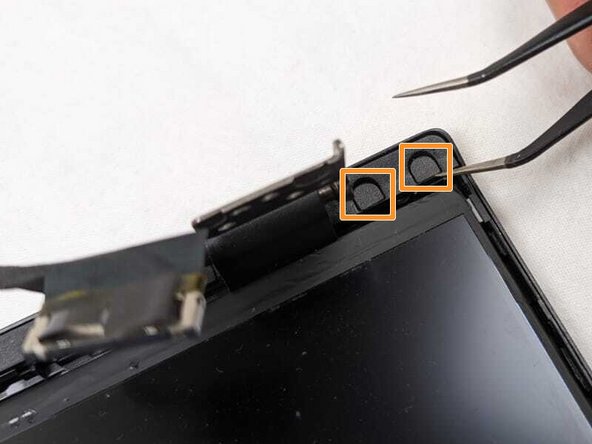

    3. why! NS5xAU Screen Replacement, Screen 3: step 19, image 1 of 2 why! NS5xAU Screen Replacement, Screen 3: step 19, image 2 of 2
      • Lift the screen.
      • Remove the adhesive and unplug the cable.
